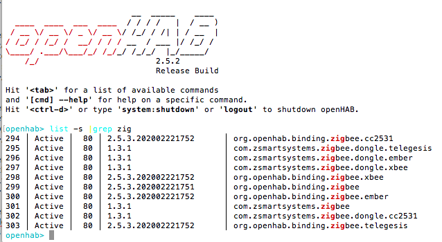

So my current setup is as follows:
Openhab 2.5.2
Dongle: Bitron Video (Ember)
Zigbee Version: Snapshot updated today (27.02.2020)
I have two Innr Smart Plugs which are working fine.
The Aqara devices are found by the binding, but the things is: Offline - Node has not completed discovery.
