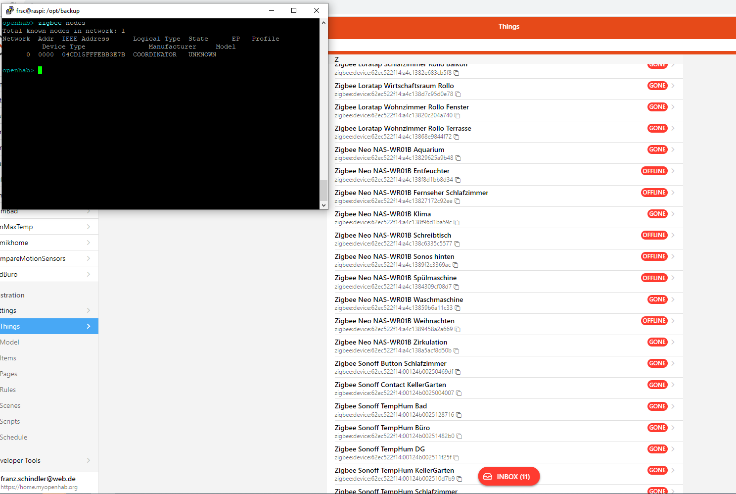

as I did not found an answer in the documentation of the Zigbee binding I just waned to as the question what’s the exact meaning of the initialize device switch in the thing?
The switch sometimes appear sometimes more often then once as shown here: (I use an ember coordinator)
The device initialisation option will initialise the device again. This configures the “binding and reporting” configuration within the device so that it sends the appropriate reports to the binding when things change.
