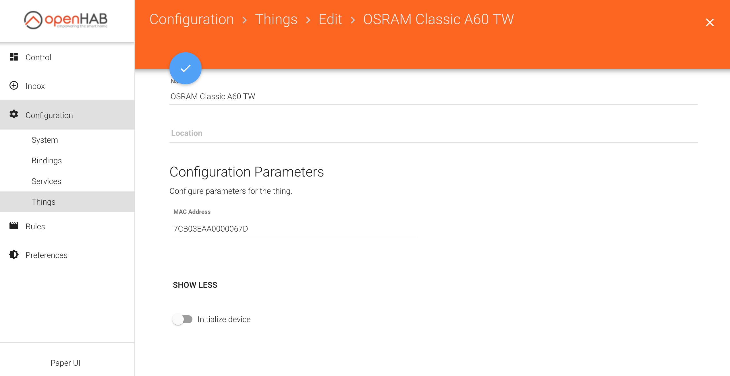

But you will have reset the device back to defaults, and it may not have been reconfigured. Try to reinitialise the device using the binding option for this thing.
Not sure what you mean.. How to reinitialise a zigbee device? Remember, Im using the 2.5M1 binding.
See the option in PaperUI or HABmin.
I don’t recall when this was added so I’m not sure if it was available in 2.5M1 or not. Unfortunately though it’s not, then I can’t help you if you’re running an old binding.
Updated the binding. reinitialised the device.. Cant say it changed anything.. Still more frequent lumiance update than ever before.
Reporting/polling configuration is not available in 2.5.0M1, you need a recent snapshot. And make sure to use HABmin, not PaperUI.
