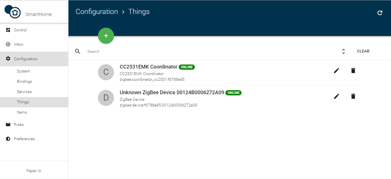

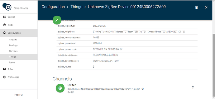

Hi @chris,
I spent couple of days work on my own end device and finally got some solution to set device
type,profile id,and end point and input clusters and output clusters.
End Device Configurations:
device type : 0x02(End Device)
profile id : 0x0104(Home Automation profile Id).
end points : 0x07(end points same for both coordinator and end device)
input clusters :
inClusterList[0] = 0;
inClusterList[1] = 3;
inClusterList[2] = 4;
inClusterList[3] = 5;
inClusterList[4] = 6;
output clusters:
outClusterList[0] = 0;
I have shared end device configuration file.
EndDevice.txt (23.6 KB)
Thanks and Regards,
Amar.
