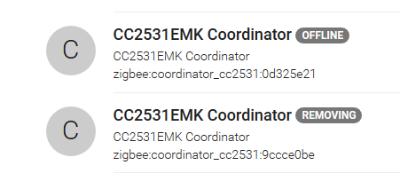

After much of testing i now ended up with 1 coordinator that is in REMOVING that never vanishes (even after reboot) and another one that is OFFLINE but set correctly…
What is the safest way to get rid of these THINGS and start from scratch? Would a removal of the binding and reenter help, or these “dead bodies” would stay the same place. Where could i remove them the hard way by changing config files directly?

If your efforts through PaperUI are simply not working, you can manually remove the entry from the JSONDB. Here be dragons. You need to be very careful to not accidentally delete too much or leave parts of this Thing behind or you will corrupt all your Things. Look into and make sure you understand JSON before proceeding.
Stop openHAB
Open /var/lib/openhab2/jsondb/org.eclipse.smarthome.core.thing.Thing.json
Find the JSON entry that defines the coordinators (that random string at the end of the Thing ID would be a good search term. The entry will look something like

There is only one entry per Thing. However, if you have any Items linked to it’s Channels, you may need to edit org.eclipse.smarthome.core.thing.link.ItemChannelLink.json to remove the links.
The JSONDB file is probably slightly corrupt or there is some other issue with the file. You probably need to be prepared to restore the file from a backup if this manual delete doesn’t work.
