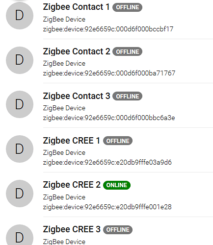

I feel like I have tried every combination of deleting and then adding back through Paper UI. Sometimes this works and other times it doesn’t. Earlier today I deleted all of the things, since they all showed as offline, and added them back in Paper UI. Now 2 of the 5 motion sensors are working again and the rest show up Online but don’t detect motion. Some of these will show the battery level and temp but no motion, temp and no battery and no motion… I think you get the picture. I’m pretty confident if I did a reboot right now then everything would come back as Offline.
BTW, sometimes the motion sensors are added back as SmartThings Motionv5 and other times they are added as “Unknown ZigBee Device”.
Just checked the Sengled light and it is showing Online but not working any longer. I can move the slider and the logs will show " Command for channel zigbee:device:213bd675:b0ce1814034b2a34:B0CE1814034B2A34_1_switch_level –> " but the light doesn’t change.

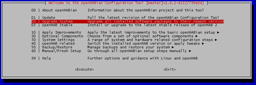

Same here, using Openhabian. After I performed an update via option#2 (see picture below), zigbee devices went offline and refuse to come back online despite a power cycle of my raspberry pi (a proper shutdown). The same issue has happened to me on 3 other occasions too. I hate having to delete, reset, and re-add my devices repeatedly. Please help with this issue.

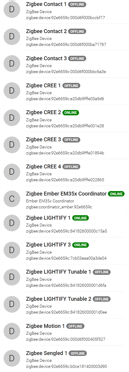

After less than 24 hours I started losing some devices (they would say Online but I wasn’t getting any data). Sometimes they would come back after restarting the service but last night everything was showing offline after the restart.
As of now, I have only 1 of my motion sensors working and it’s the one in the same room as the pi. The 2nd most reliable motion sensor is in another room not far away, but the remaining 3 that are somewhat far away in the house and are the most inconsistent.
