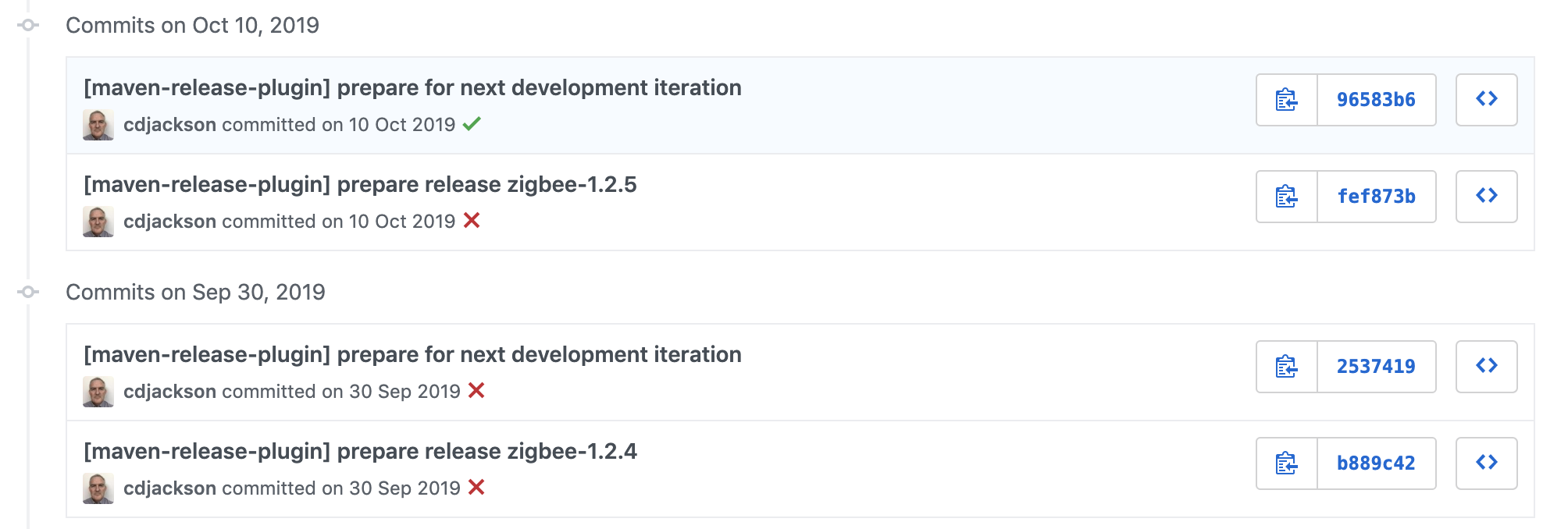

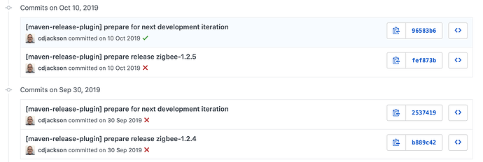

There were no changes at all to the TI driver between these two versions. This is the history list for the driver -:
Yeah, I realize that and believe me it did surprise me a bit. I have two theories at the moment:
