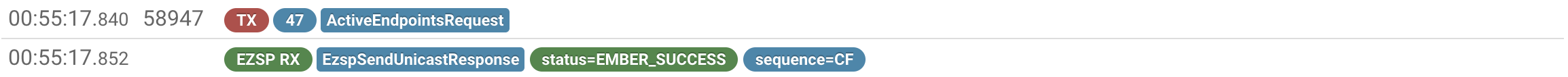

Unfortunately I can’t see why this isn’t working. The binding receives the notification that the device has joined, and the binding starts the discovery to find out the endpoints and services, but there are no responses from the device, and the dongle returns that it cannot contact the device.
This sort of sequence where the binding sends commands to the device repeats a number of times but there are no responses. Either the network join was not really successful, and the device maybe left, or the device is simply not responding - it’s impossible to tell from logs at this level.

Yes, I can see this joining, and the binding requesting all the initial information required to discover the device.
What do you mean by this? It looks like the join is fine and the binding is communicating with the device.
I suspect that the device has either gone to sleep, or maybe it’s left the network as it didn’t receive something it expects - unfortunately it’s difficult to know. All the initial communications to establish the device have worked fine - the device responds quickly, but by the time you add the thing, which is where the channel discovery occurs, the device is not responding - it’s either asleep, or has left the network.
Unfortunately it’s going to be difficult to tell what’s up from here without a network sniffer and/or information from manufacturer.

In zigbee_debug_log5.txt (OH 2.5.0.M6) at 03:21:16.614 it starts to discover the attributes of the clusters. The device responds to this requests for cluster BASIC and OTA_UPGRADE. At 03:22:40.326 the attributes for POWER_CONFIGURATION are requested. This is when it stops to respond.
Now when I look into zigbee_debug_log6.txt (OH 2.4.0) I can see this attributes discovery from 23:23:24.187 on. Here it also works until attributes for cluster POWER_CONFIGURATION are requested. But here we see a response with statusCode=UNSUP_GENERAL_COMMAND
And (not sure if it matters) in zigbee_debug_log6.txt (OH 2.4.0) after the Attributes discovery there is a ManagementBindRequest and response which can not be seen in zigbee_debug_log5.txt (OH 2.5.0.M6).
The join worked fine on the previous log (from 2.5 I think). This is not the issue. It joins, it gets discovered - that’s all fine. The issue is with the discovery of the channels and possibly that the device is expecting some sort of watchdog.
Unfortunately it’s quite hard to diagnose why it would (apparently) leave the network as this is not normal behaviour for ZigBee devices and without a sniffer log, it’s impossible to tell.
