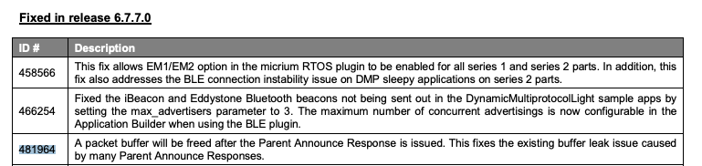

Finally identified the bug - there is a low level stack bug in the SiLabs EFR32 used by IKEA devices that causes them to crash.
This bug is fixed in Emberznet 6.7.7 and higher from SiLabs – but a majority of IKEA devices are running earlier 6.0 to 6.5 releases that are all affected by this bug.
The bug occurs when a bulb is processed a ZDO parent announcement and other traffic arrives. Seems to be triggering more often on large networks.
Have some test code that does a ZDO parent flood and can now reproduce on demand.
