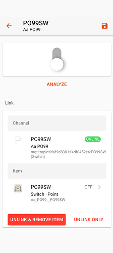

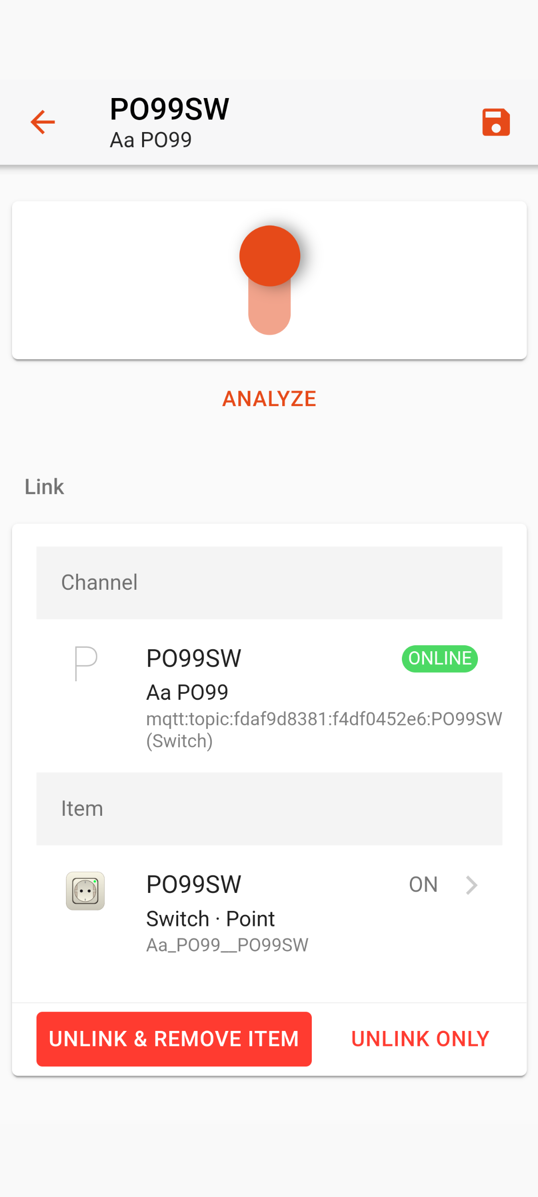

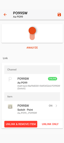

Physical PowerOutlet connected to 220v.
Turn OH Switch off.
Please notice the red dot: switch is Off for OH.
Now turn OH switch On.
Please notice the green dot: switch is On for OH.
Physical PowerOutlet goes Off and On. Great.
Now physically unplug the PowerOutlet and do it again:
Same result (I won’t post the same hard copies ! ).
For OH, the PowerOutlet goes On and Off, although we know that nothing really happened because the PowerOutlet is unplugged.
