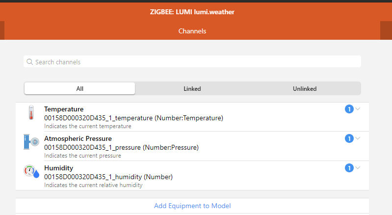

Hi
after upgrading to OH3 my Aqara Temp Sensor stopped reporting.
I deleted the Thing and just hit Scan again.
The thing was found again.
However it is not discovered with less channels.
Battery and Link Quality is gone.

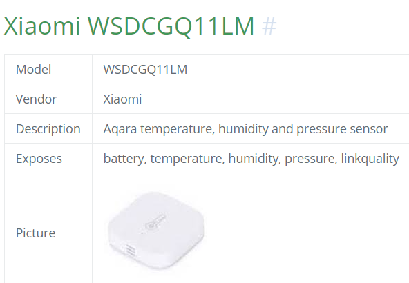

There are at least 4 different ways to get this sensor integrated into OpenHAB.
zigbee-binding (from @chris )
mi-home binding (you need the mi-gateway then)
mi-io binding (you need the mi-gateway then)
mqtt-binding with zigbee2mqtt
There may be different channels regarding which way you use.
Are you sure you used the zigbee-binding in the old installation?
The screenshot you posted, is from zigbee2mqtt for example.
