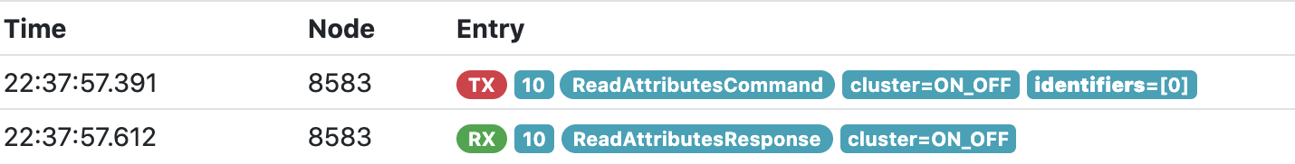

I was able to turn on the DEBUG log level, and created the attached log file that is more comprehensive and probably useful in diagnosing the issue. openhab2.202011262238.log (126.9 KB)
What does the log show? ie what did you do - did you send commands to turn the light on, or what?
The log actually shows very little - just a single attribute poll to some device (O’m not even sure if it’s the device that has the problem as you don’t say what device ID etc this is). There don’t appear to be any commands to change the state of the device though.
I’ve been plugging away at this. The fact that the log was devoid of any instructions, even in Debug mode, was a helpful clue that told me there was something fundamentally wrong with my setup.
Ultimately, I think the issue was related to permissions on the USB controller and the fact that they were not set when the original Docker instance was spun up, but I’m not entirely sure. I did a couple troubleshooting steps:
