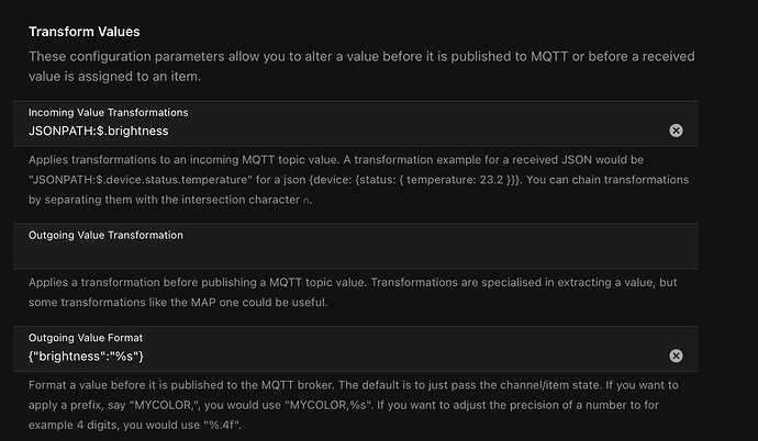

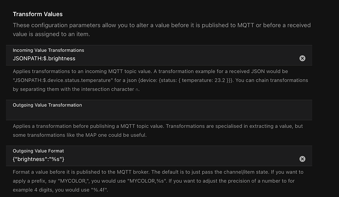

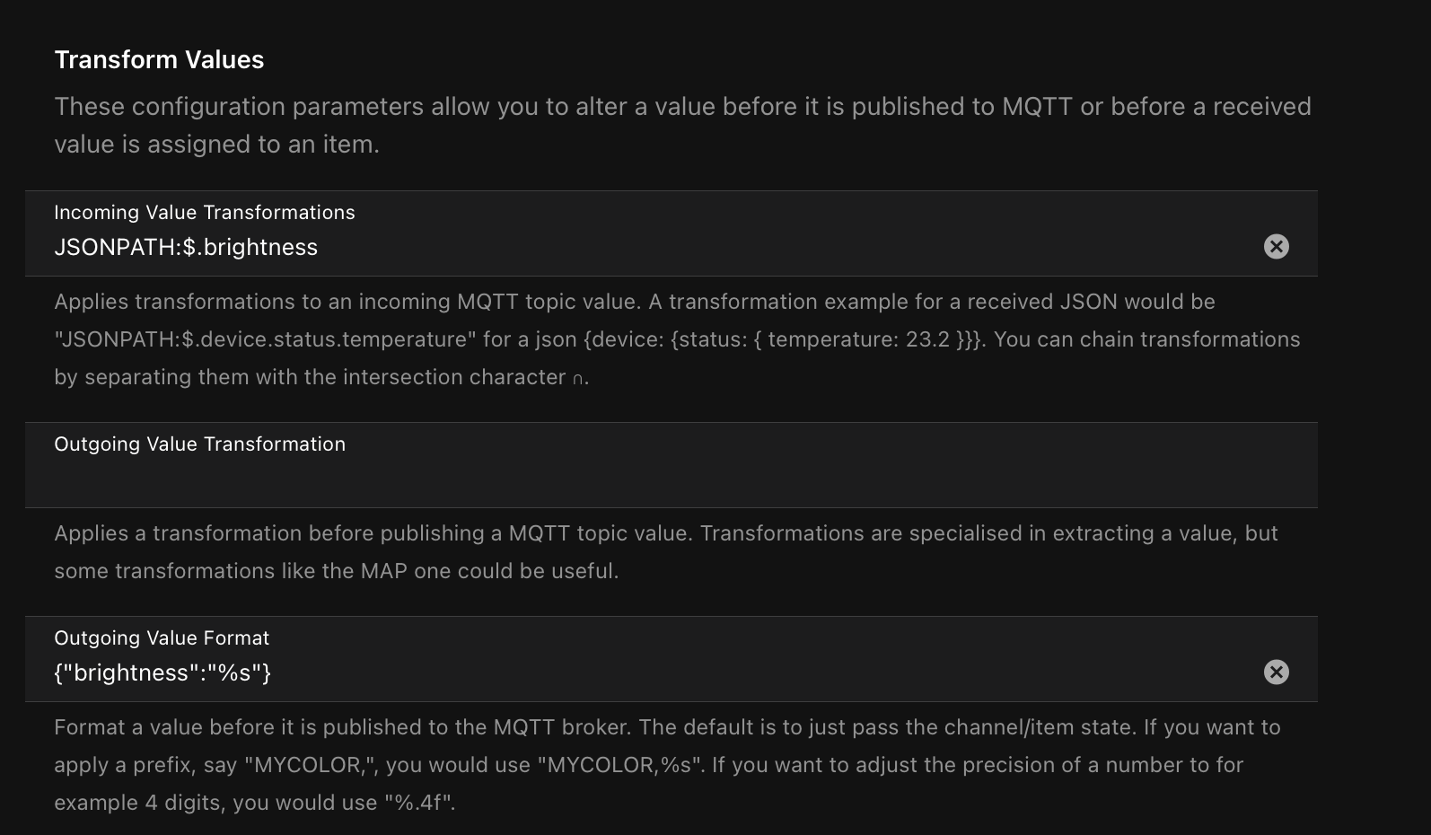

On top I don’t know if this is the right way of performing an outgoing JSONPATH Transformation even tough it is working for me.

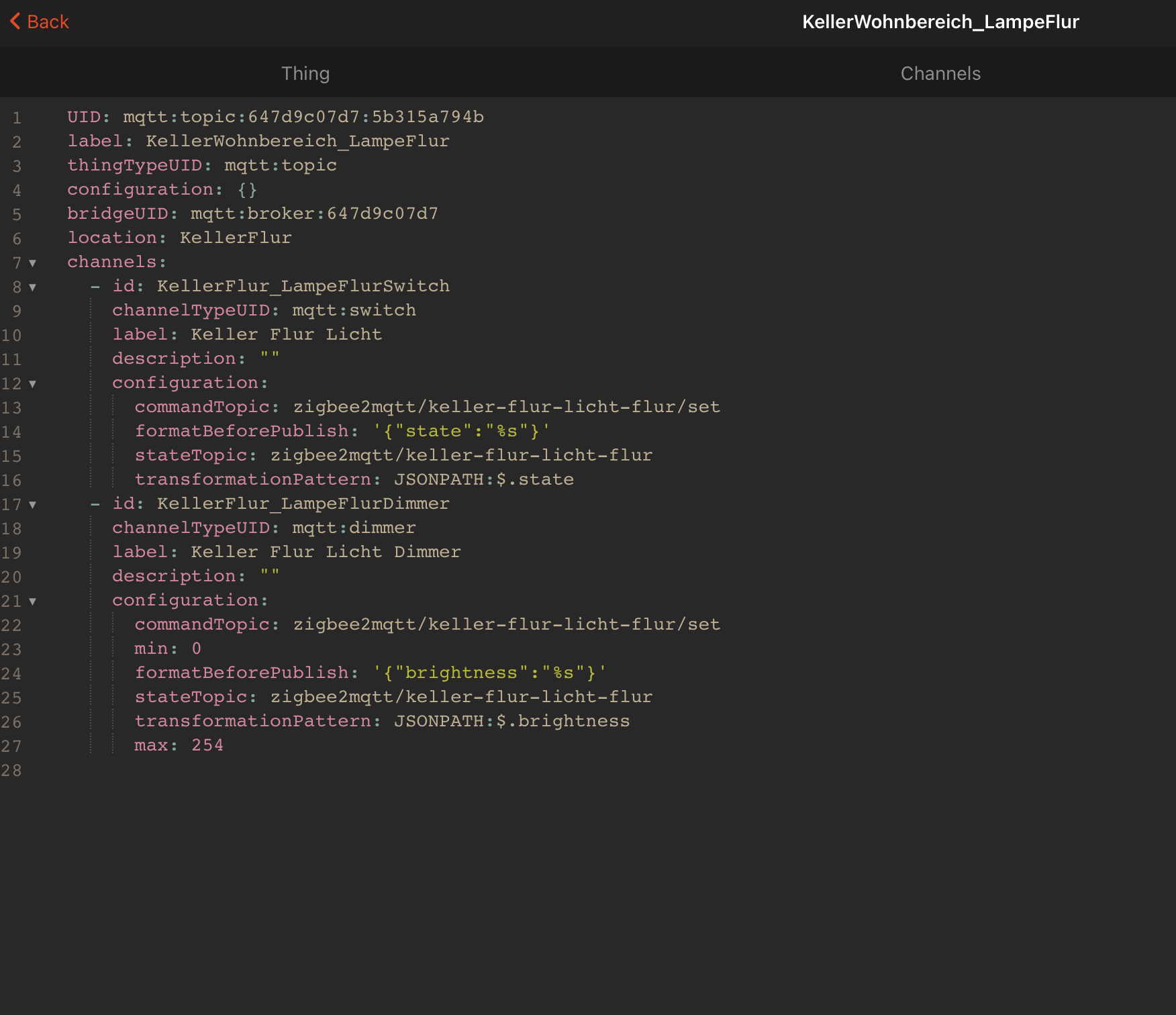

the real problems begin when I create an generic MQTT Thing for controlling the brightness of my lightbulbs. These take values between 0 and 254 and I created a channel with a percentage value and set the min and max value to 0 and 254.

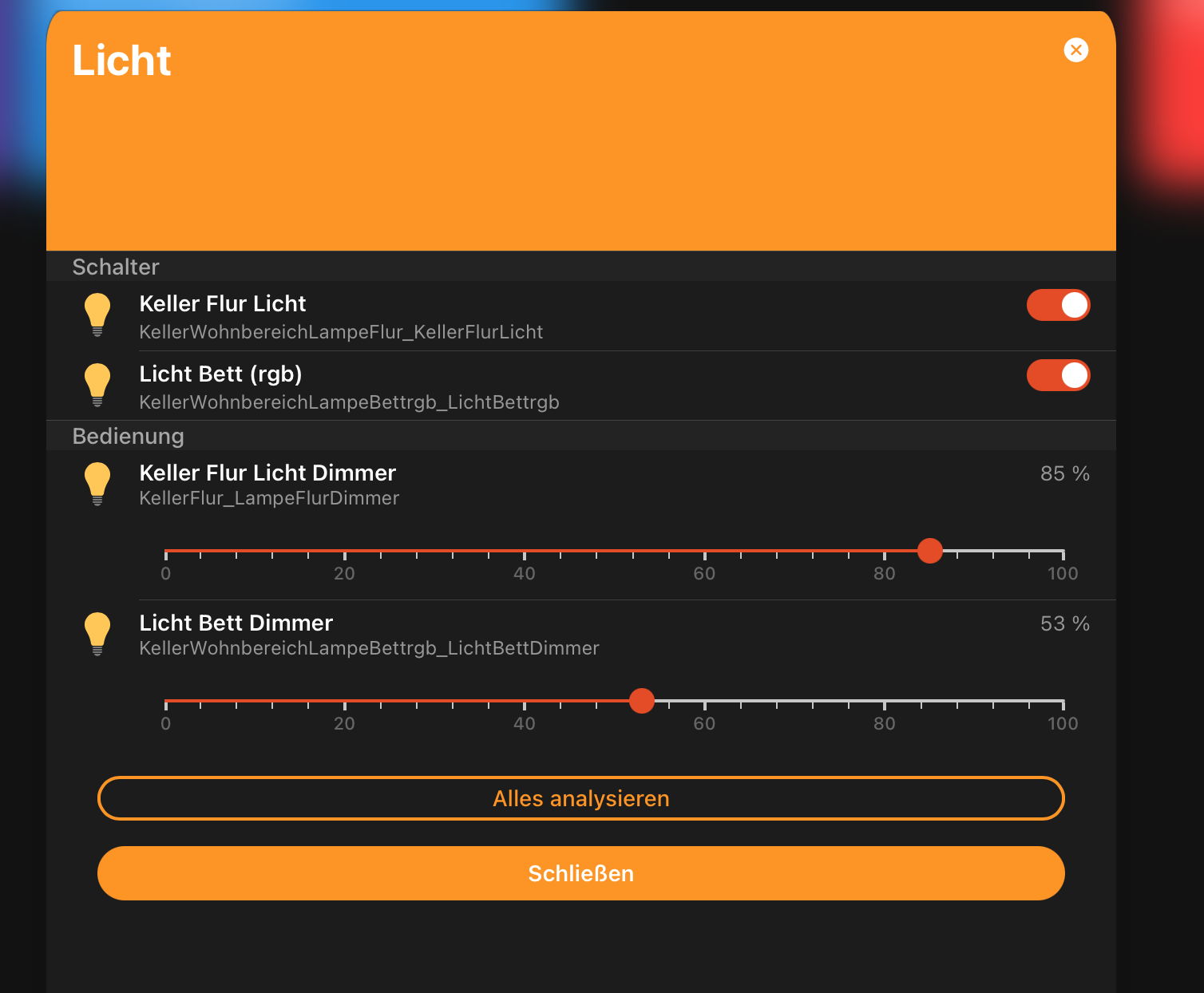

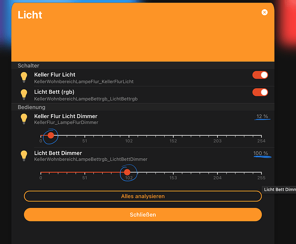

For Some reasons the control elements sometimes show the value of the dimmer in percentage and sometimes in absolut numbers between 0 and 254. I added a screenshot of both of them being mixed and therefore creating a lot of problems and leading to the result that no command is sent at all at some point.

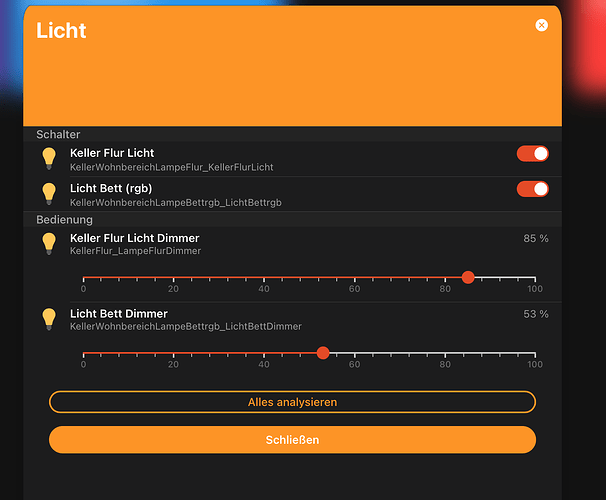

After a complete reboot of my raspberrypi it looks like this without changing the configuration of these Channels and its working as it should:
