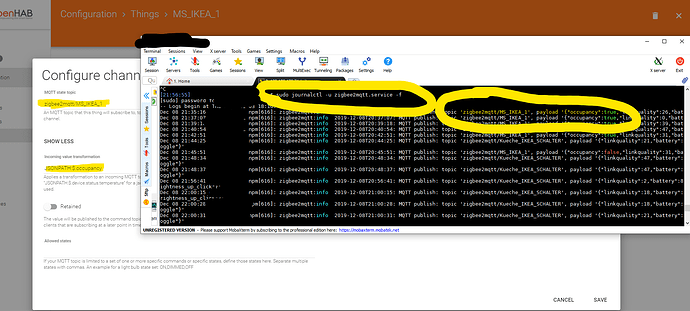

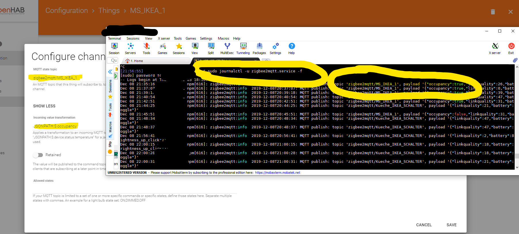

Hi Andrew i am sorry for the late reply.
  1. First you have to create an Generic MQTT Thing with the MQTT Binding. (you need to add it manually – openhab won´t find anything by itslef)
    The only configuration you have to do, is to choose the Bridge in section " Bride selection" there you choose your MQTT Broker.
  2. Secound step: create Channels for you created generic MQTT Thing.
    The configuration should be done like you can see in this Screenshot:
    in field MQTT state topic you choose the MQTT output from your jorunal, in my case “zigbee2mqtt/MS_IKEA_1”
    in field incoming value transformation you need to type in JSONPATH:$. and the value you want to transform, in my case: JSONPATH:$.occupancy, because i am using a motion sensor.
  3. After you create a channel you will be able to create an item, after this, everything works like you now it from openhab.
Hope this helps you, if you have further questions just ask :slight_smile:
BR
Chris
