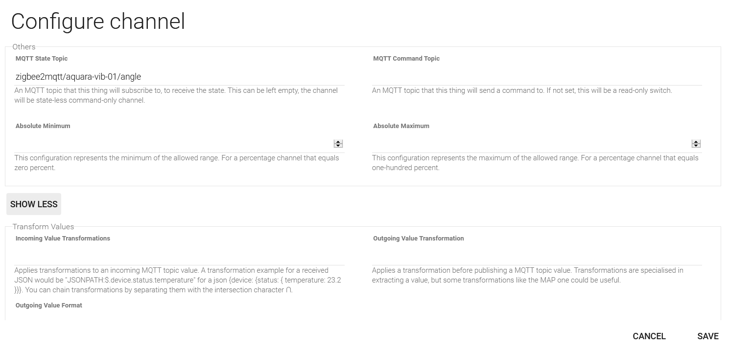

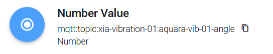

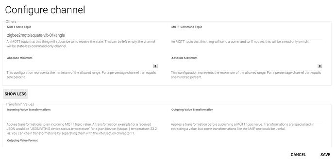

Has anybody a working config for the Aqara Vibration Sensor - for whatever reason I fail.
Sure, but it won’t help you much as mqtt channel names are individual:
Number Xia_Vibr_01_Battery "Vibration Sensor [%d %%]" <battery> { channel="mqtt:topic:xia-vibration-01:aquara-vib-01-battery" }
Number Xia_Vibr_01_Linkquality "Vibration Link [%d]" <qualityofservice> { channel="mqtt:topic:xia-vibration-01:aquara-vib-01-linkquality" }
DateTime Xia_Vibr_01_lastseen "Vibration Lastseen [%1$td.%1$tm.%1$tY %1$tH:%1$tM]" { channel="mqtt:topic:xia-vibration-01:aquara-vib-01-last_seen" }
Number Xia_Vibr_01_Angle "Vibration Angle [%d]" { channel="mqtt:topic:xia-vibration-01:aquara-vib-01-angle" }
Number Xia_Vibr_01_Angle_X "Vibration Angle X [%d]" { channel="mqtt:topic:xia-vibration-01:aquara-vib-01-angle_x" }
Number Xia_Vibr_01_Angle_Y "Vibration Angle Y [%d]" { channel="mqtt:topic:xia-vibration-01:aquara-vib-01-angle_y" }
Number Xia_Vibr_01_Angle_Z "Vibration Angle Z [%d]" { channel="mqtt:topic:xia-vibration-01:aquara-vib-01-angle_z" }
Number Xia_Vibr_01_Angle_X_abs "Vibration Angle X abs [%d]" { channel="mqtt:topic:xia-vibration-01:aquara-vib-01-angle_x_absolute" }
Number Xia_Vibr_01_Angle_Y_abs "Vibration Angle Y abs [%d]" { channel="mqtt:topic:xia-vibration-01:aquara-vib-01-angle_y_absolute" }
Number Xia_Vibr_01_Strength "Vibration Stärke [%d]" { channel="mqtt:topic:xia-vibration-01:aquara-vib-01-strength" }
String Xia_Vibr_01_Action "Vibration Aktion [%s]" { channel="mqtt:topic:xia-vibration-01:aquara-vib-01-action" }
Edit: Here is an example for the action channel:
Thanks - works now perfectly.

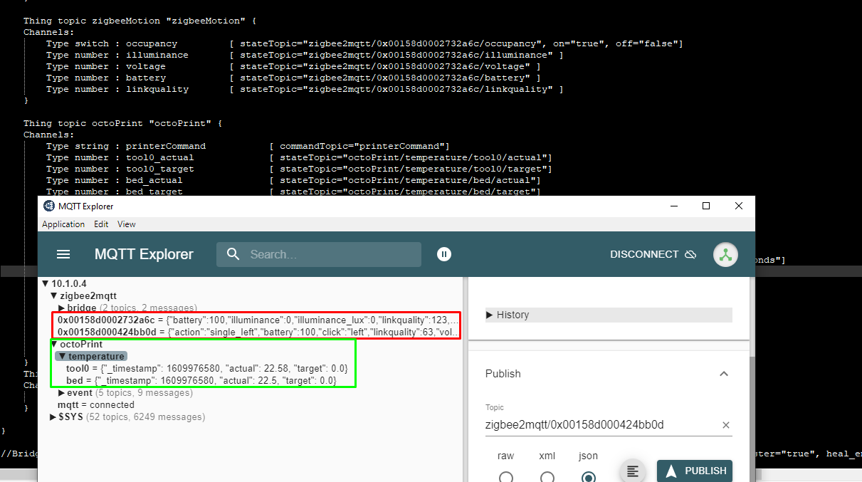

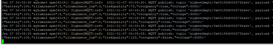

Hey guys.
I’m desperate and need more eyes for this. I don’t understand what’s broken there.
I’m using zigbee2mqtt on my OH2.5 for some xiaomi devices and octoprint server. Everything works fine. Now I’m trying to set up OH3. So I did copy of my items and things files for new OH3 version. mosquitto works fine. I’m able co connect and I can see topics. But I don’t understand why I have everywhere NULL values in zigbee Items.
I’m using same bridge for zigbeemqtt and octoprint server, and octoprints channels works just fine. There are correct values in items. But zigbee devices not.
log from zigbee2mqtt looks also ok:
Any idea what I have wrong there?
Ok, it seems working after few hours :confused:
