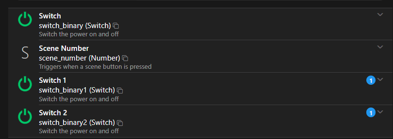

What do the blue circle “1”s mean on the Channels?
By review the parameters I meant for you to make sure they match the type of switch, etc.:wink:
The blue 1 means 1 item is linked.

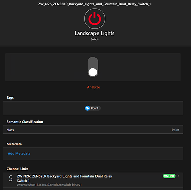

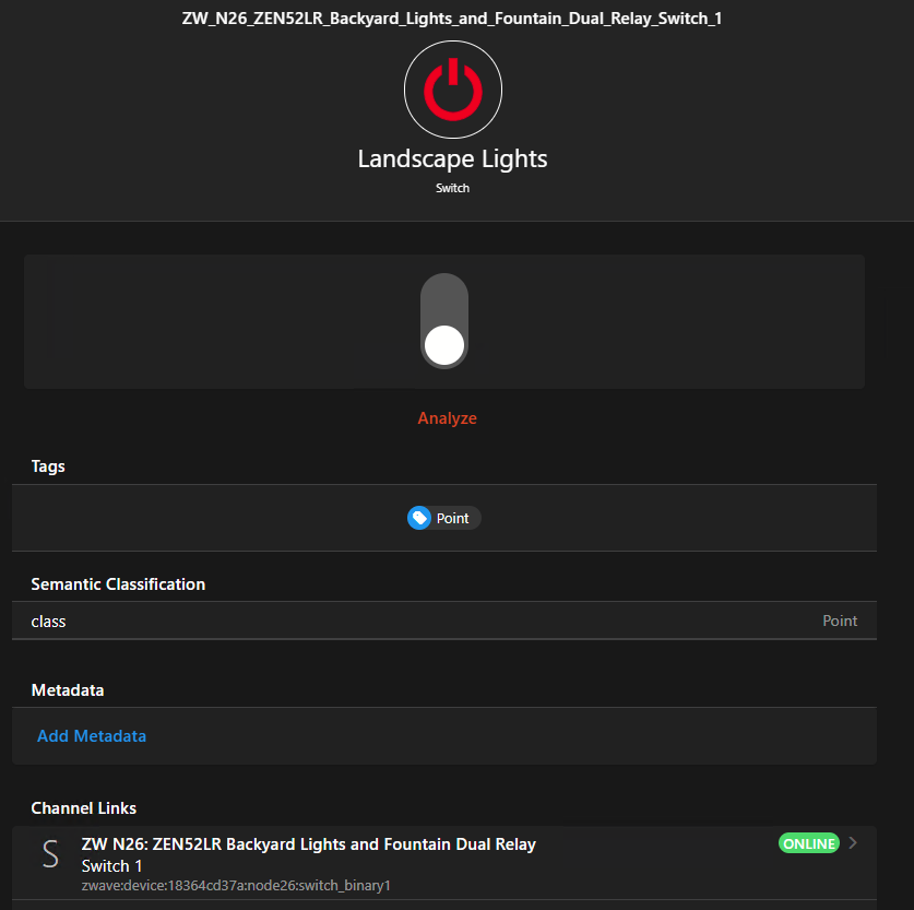

I think there is something wrong with the widget since your event logs show communication. Also you are getting both endpoint 1 and root events. Edit:Nevermind I see you are only getting root from manual.

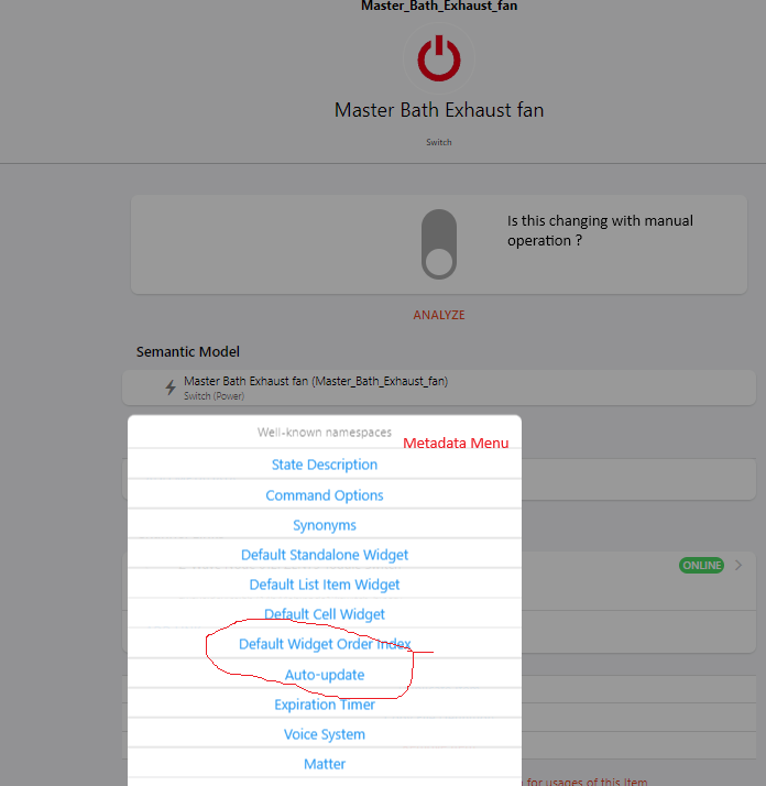

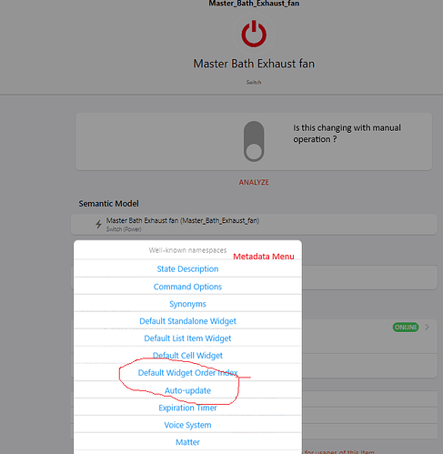

Let’s start with this; On the UI item page are you getting the status update from a manual on/off
Edit: as to the rule, I have been around too long and am lazy, so still have the unpreferred DSL rules (that work-that is where the lazy part comes in). Once you get the scene numbers coming from the manual switch operation open a separate topic or try copilot (since you are on windows) for a java script suggestion
That does not change when I toggle either manual switch
Did I need to select something from the metadata menu?
Also, do not see “Semantic Model” on my page.
It appear you are getting communication on the root, so the individual switches are not getting reflected. The issue probably is the device is set up that way, so the scene idea might be the only solution. (see my above for rule) The only thing that seems odd is the root is not linked to an item.
The autoupdate is in the metadata like the picture above.
