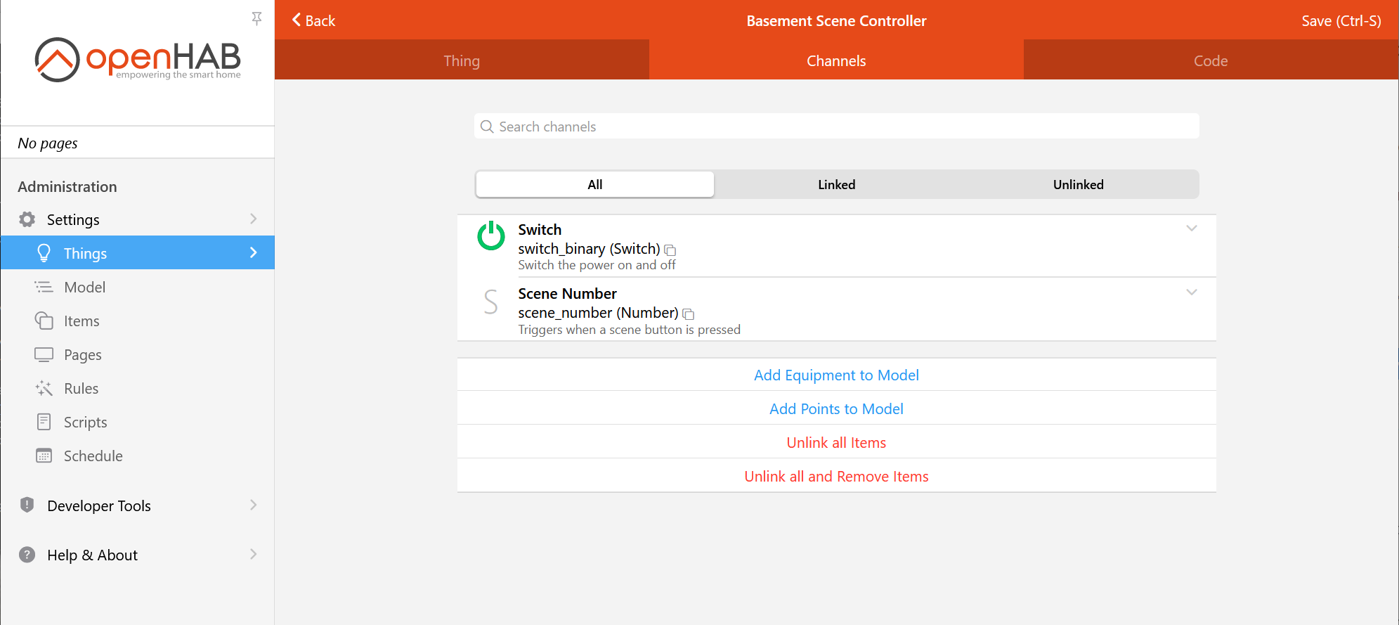

Yes, there should be a channel for each LED’s state and a channel for each LED’s color. So, you should have 10 more channels.

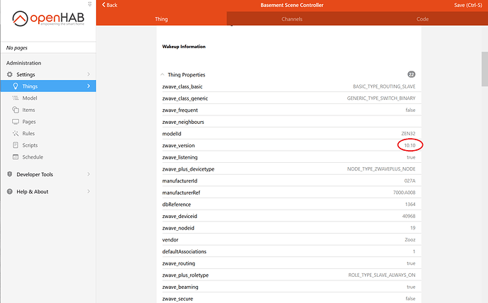

Maybe try deleting the Thing and rediscovering it? Don’t exclude it from your Z-wave network, just delete the Thing from openHAB. You should be able to add it again from your inbox. You’ll probably need to run a “scan”, but again, no need to re-include into the Z-wave network. openHAB will see the Thing already associated to your Z-wave controller and add it to your Inbox.
If you give the Thing the same name it had before you deleted it, your pre-existing items should automatically reconnect to their respective channels. And, any missing channels should show up.
