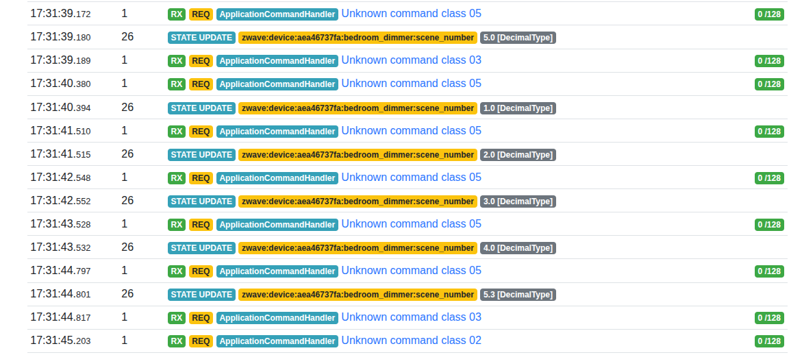

The “unknown command class 05” is super suspicious to me now when looking at the timing.

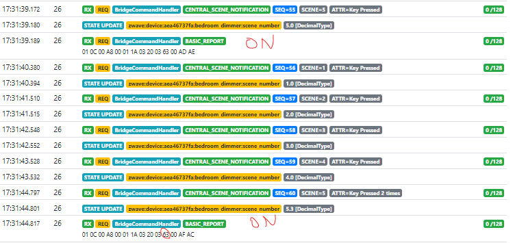

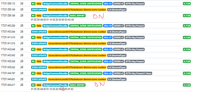

Ok, the ZEN35 is sending updates with the dimmer level, they are being sent as COMMAND_CLASS_BASIC, but the values are there.
This message shows up as “Unknown command class 03” in the log viewer:
2026-02-08 17:31:39.189 [DEBUG] [WaveSerialHandler$ZWaveReceiveThread] - Receive Message = 01 0C 00 A8 00 01 1A 03 20 03 63 00 AD AE

When following other sample XML files, I added the COMMAND_CLASS_BASIC to BOTH the dimmer and scene_number endpoints. Is that correct?
Again don’t worry about the rows with a “1”, that is a viewer problem. Here is the same snippet corrected.
What is also shown is that are you getting the basic report now, but it is not updating the UI. It should have a STATE UPDATE. Again the delete thing and scan might pick up that they are linked. (if you didn’t do that already.
EDIT: Saw your latest. I don’t think the basic should be tied to the scenes, just the switch.
Woohoo! Removed it and re-added and now the dimmer state updates!
