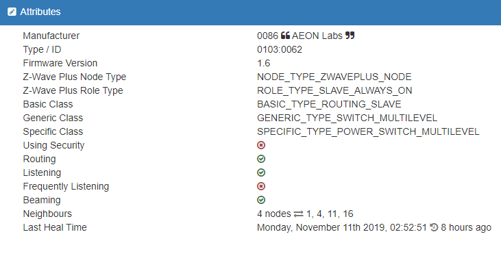

I am using 4 ZW121 Aeotec LED Strips. I installed the first three months ago. They were installed using the prior version of the Milestone release. I can’t remember which one, but it was a recent one.
I finally got a forth Aeotec LED strip discovered and have items for it, etc.

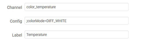

When I change the color temperature on ALL of the LED strips, I get the following error:
NODE 85: No command converter set for command zwave:device:d0c1b56b:node85:color_temperature type PercentType.
I’ll get this error changing the color temperature from HABPanel OR through a rule. The funny thing is that all of the other ZW121 Aeotec LED Strips behave just fine. Only this latest one - node85 - gives this error.
Changing the colors or the Brightness Dimmer works just fine on all of the LED Strips.
I get the command converter error only on this latest installed one. Is this somehow related to 2.5.0.M4
