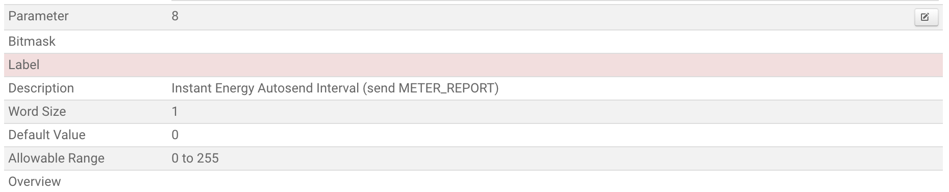

ZW500DM In-wall Smart Meter Dimmer Switch is not working properly
They are the labels for the parameters :sunglasses: .
It’s the name of the parameter that you will see in the UI.
Yep - should be perfect - thanks.
