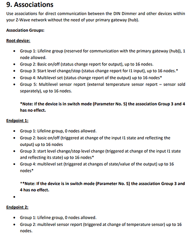

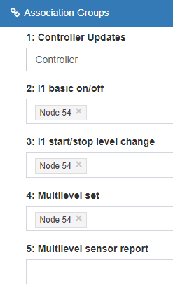

I put them in each others Association group for that input.
However when I push a switch both lights turn on at first just to turn off again instantly again.
Seems like the association 1 makes what I want to turn on the other light however once it turns on it triggers automatically via the the assoication to turn off again? confused

An command, trigged through an association sent from one device, will not (or should not!) cause the second device to trigger any commands configured through associations.

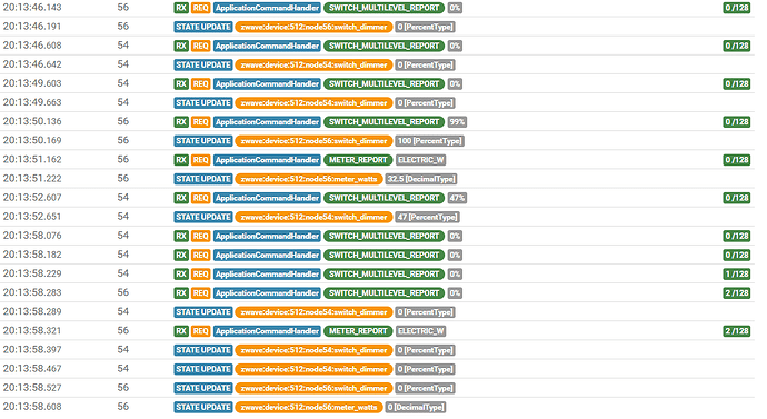

I would suggest to see if there is anything in the logs for starters.
Associations are a configuration only - you set the device to send a COMMAND, through an association group. When the reason for the association is triggered, the COMMAND is sent - not an association. The receiving node doesn’t know that the command was triggered through an association, or through a button press, or anything it - it just receives the command.
I see a bunch of multilevel commands in your log - probably these are related to the association configuration.
thats what I try to achieve and what I was expecting
If I only have set the association in one device it works
→ I push the physical button 1 : → light 1 turns on → association triggers ON to other node → light 2 turns on
However in that case physical button 2 obviously only turns light 2 on
So I tried to ADDITONALLY set the vice versa association in the other Node… which results in:
I push the physical button 1 : → light 1 turns on → association triggers ON to other node → light 2 turns on and while light 2 still dimms up → both turn off again
Ok, but what were you actually expecting to see in the log then?
It’s not super easy to see what is happening as the controller doesn’t necessarily see all the data. One option, which I would also support, is to do what @HomeAutomation suggested, and run everything through rules so you have control over what is happening.
