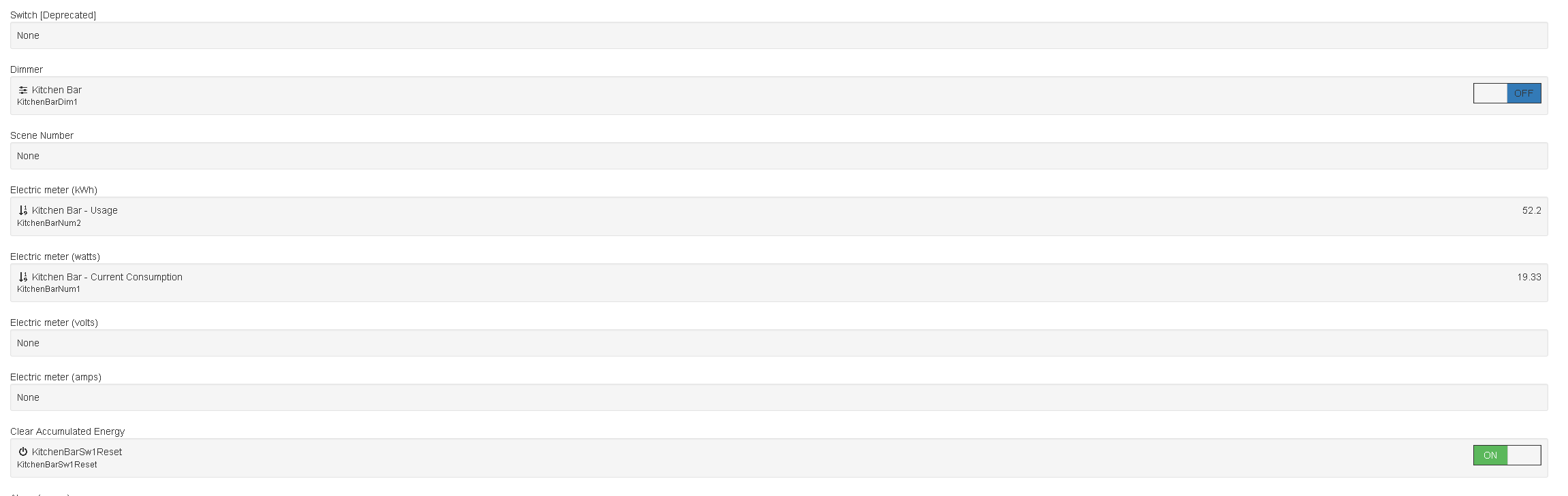

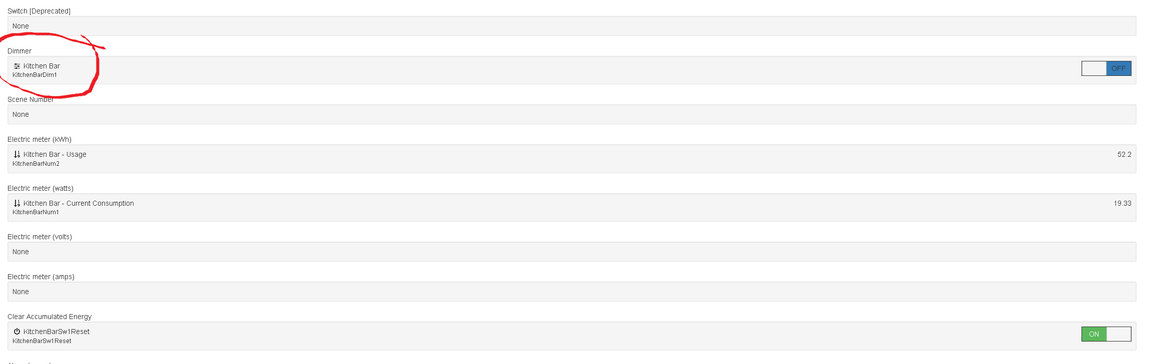

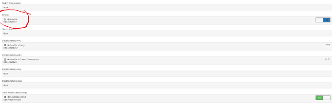

Are my links not working. It’s clear as day in the screenshot of the ITEM name linked to the DIMMER channel. If you can’t see it then there must be a forum issue not displaying the images I’m posting.
KitchenIslandDim1 - DIMMER TYPE

I wanted to see how the channel was linked, and you had not previously provided this. The image is working fine, but you hadn’t provided the information until now.
This is what I wanted to see - so it is linked to switch_dimmer channel. Now we just need to see the log :slight_smile:
Yes I did, Post #22 . Shows the item linked with the channel
That’s a channel, not shown in post 22 screenshot.
Chris is waiting on your logs for node 5 misbehaving now.
It shows the same damn thing!!! forget it.
Sorry, but that’s quite different as shown in the image above (edit: To be clear - it shows the item, but it does not show the channel and from the binding perspective, it’s the channel that is important as the binding knows nothing about items - only channels).
Anyway, we now see the channel information. Please can you provide the log showing what happens when you try to send a command to it - I’ve still not seen this, and it’s really impossible to comment on what’s happening without this.
