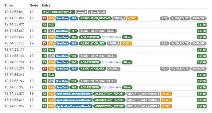

I tried removing the Controller and re-add. (how long should the pending... last on non-battery devices?

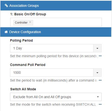

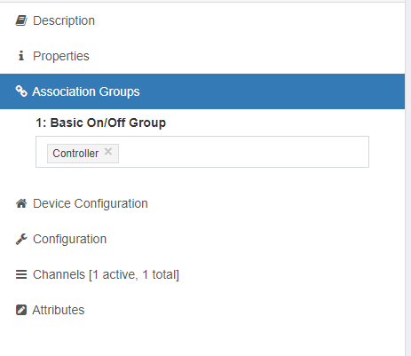

I believe the associations is correct? (default was none)

While there seems to be an issue with removing the association, the important thing here is it shows that the device has the association configured as this is read back and displayed in the log.
