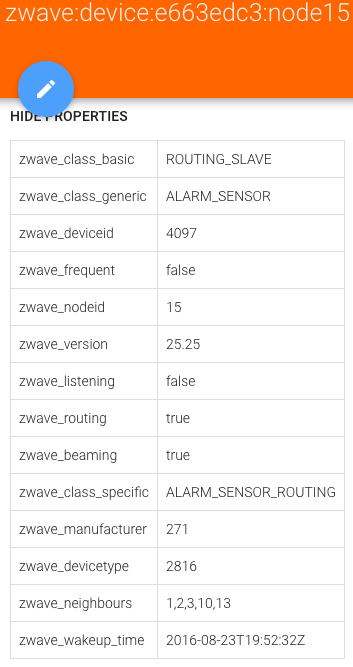

So the issue is that you probably have the old version, but because it’s reporting version 25.25 it’s using the config defintion of the new version. These two versions have different parameter definitions and that’s causing the error.
It’s the same discussion as this thread
We would need to create a new version to solve this - one specifically with the 25.25 version number. Can you please post four XML file?

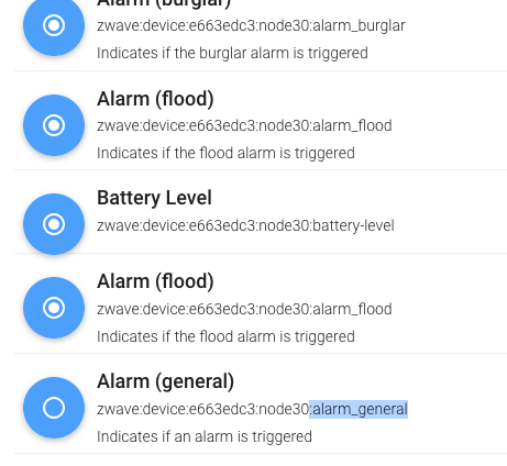

Channel “Binary Sensor” (:sensor_binary) : not tested (no linked item…)
Channel “Sensor (temperature)” (:sensor_temperature): FAILED - No data updated
Channel “Alarm (burglar)” (:alarm_burglar): FAILED - No trace in logs
Channel “Alarm (flood)” (:alarm_flood): FAILED - Item “FloodSensor_FrigoInside_Alarm” in Basic UI not updated (and my alert rule not triggered) - see Logs #1
Channel “Battery Level” (:battery-level): OK (battery level seems updated)
I have reinstall a “fresh” OH2 instance and disable/enable the items of node 30 (FGFS101 flood sensor).
Now, I have executed the following test case: To check the flood sensor alarm
Results: the channel :sensor_binary1 is updated to ON (see the following log) but specific channel (:alarm_flood) is not updated… Is it normal ?

2016-08-26 00:05:23.753 [DEBUG] [ding.zwave.handler.ZWaveThingHandler] - NODE 30: Updating channel state zwave:device:e663edc3:node30:sensor_binary1 to ON [OnOffType]
Comment #1: the description “Flood Sensor” of this device (25.25) is missed in Zwave database
Comment #2: in OH1, the Fibaro FGFS-101 flood sensor has a Tamper property (Switch swFibFlood_Tamper "Water-Sensor: Tamper" { zwave="11:command=sensor_alarm, alarm_type=0,respond_to_basic=true" } - from Wiki page https://github.com/openhab/openhab/wiki/Z-wave-Binding-Examples#sensors). What is the channel of this property in OH2 ?
It looks like the device is sending the BASIC class in the log you show, and there is no endpoint set to basic in the database. It probably should be the sensor_binary that is set to BASIC - please feel free to update the database appropriately.

This would be the Alarm General channel. The database doesn’t know that this is a tamper unless someone actually updates it. Again, please feel freee to update the database.
I doubt that this should have respond_to_basic. That would mean that the main function of this device is a tamper alarm . As above, it is more likely that the sensor_binary should be set to BASIC.
