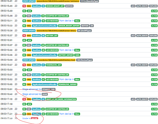

It seems most (all) of the devices with the problem are battery powered. My initial suggestion was to wake the device by pressing the button per the manual (usually 1-3 times quickly). I’d still suggest that sequence maybe a minute apart until the xml shows up in the zwave folder.
With some devices pulling the battery out, waiting a bit and putting back in will do the same thing. There is sometimes a 30 -60 period when the device is awake and will get configured. Using the log viewer, the end will like this

All logging is done by the ZW binding. The device communicates with the controller and OH communicates with the controller. The trigger could be a message from the controller to OH (relaying a device message or the controller informing OH of something it is doing) or a command from OH to the controller. The binding translates those bytes into human readable form.
In the pictures above the red TX means OH to Controller and the green RX means OH received from controller. The light gray RES is just between OH and the controller. The yellow REQ is from the device via the controller (note the blue from device in)
