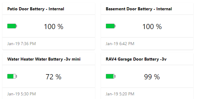

I use the first method outlined by @rossko57 (timestamp on the battery channel) and then use a label card in the UI with the footer showing the time. Excerpt below:
Bob

If you are doing a footer in the label card
Use =items.youritem.displayState
