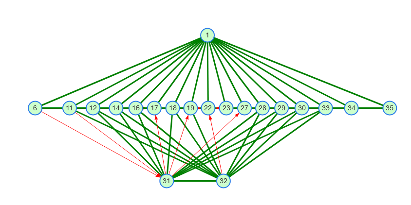

Been reading up on other threads complaining about slow zWave performance; no sense wasting your time if it’s a topology issue :slight_smile: Several suggestions were to confirm the zWave network and look for missing nodes - Checking HABmin, I see this:
What do the red arrows / links mean? As per this post earlier in the year, even @rlkoshak is unclear… I’d be great to have a legend to decode the map.

They mean that there is only a one way connection reported from the neighbour tables. So one side reports the other is a neighbour, but the opposite is not true.
I’m by no means an expert on Zwave. The fact that I don’t know should not be all that surprising.
