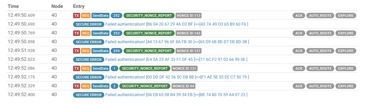

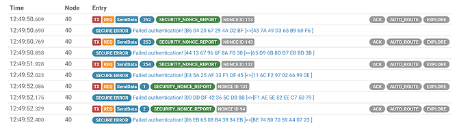

I then manually clicked the switch on the wall and filled the logs to @chris 's log viewer which outputs the following:
Looks to me like a security thing? What do you think?
