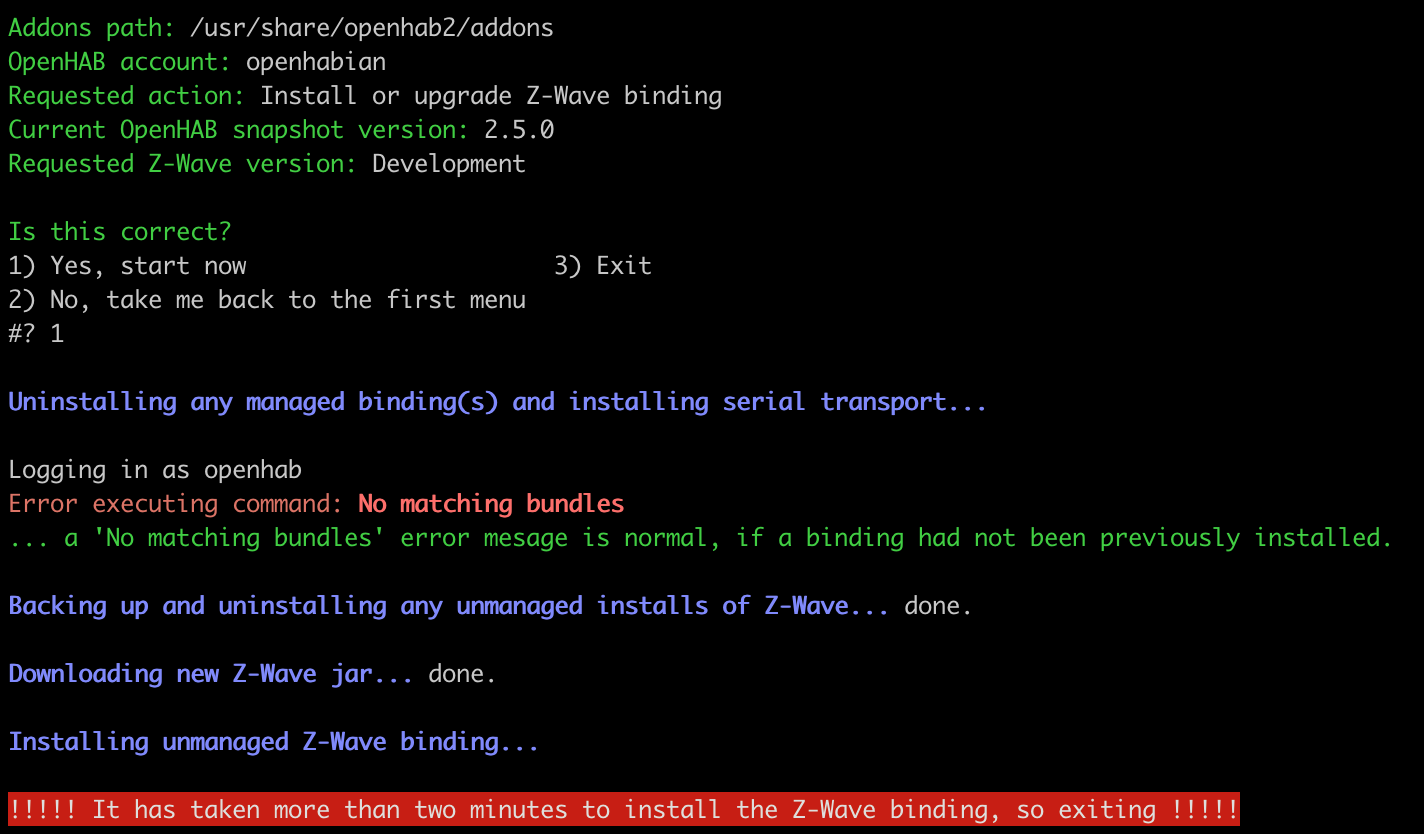

I have only installed the snapshot binding.
I believe the development option is only used when working with Chris to troubleshoot an issue where he makes a binding outside the normal build system. Since there currently is no such version, the script times out.
If you do not show a zwave binding installed you may need to choose the Snapshot binding again.
