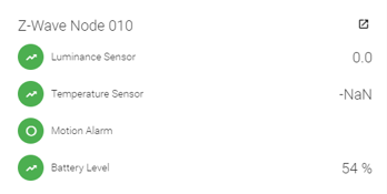

Today At about 14:00 I realised the motion sensors doesn’t Trigger (From OK to Alarm ) when motion happens.
This happened on two of these sensors (4 in total)

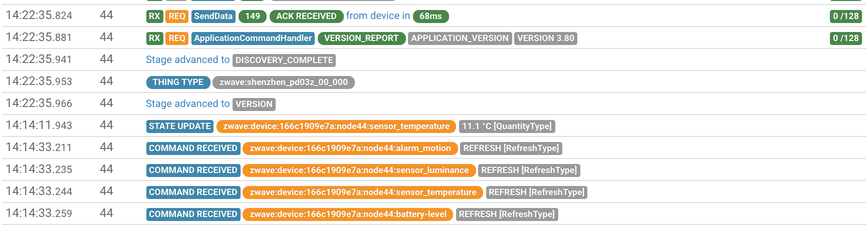

I took the sensor form the wall and put it on the table. I performed tests on the sensors (moving my hand in front of the sensors.
I began about 14:12 these tests (I had Habpanel open and sometimes clicked the “refresh” button which might be mistake.
While I was moving every about 40 seconds my hand in front of the sensor. The sensor was always not “triggering” motion.
Example: at 14:19:20 the temperature update is because of my hand moving in front of the sensor.. but no motion there.
This behaviour on the same test after the NIF+ wake at: 14:28:11.919
Instead i noticed the temperature to be updated! for some reason (in the logs everytime you see a temperature report, is triggered by motion.

It’s a little hard to piece this together, but I make the following observations -:
  • the wakeup earlier in the log (eg at 14:14:57.761) does get detected, but there is nothing to do as the device has already completed the initialisation.
  • What makes the NIF work later is that you have sent the reinitialise command at 14:22:28.065. Therefore, when you send the NIF, which does the same thing as the WAKEUP, it does something as you have restarted the device initialisation.

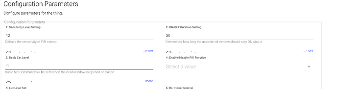

  • You have set some configuration parameters - parameter 4 being one of them and this parameter disables PIR. Maybe at some stage you had disabled it?
  • We see motion alarms at 14:23:42.965.
So, I suspect that at some point, you have disabled the PIR. It continued to report luminance/temperature. Waking up the device didn’t make any difference initially, but you changed the configuration, and then sent the NIF/WAKUP which transferred your configuration to enable the PIR, and after this, the PIR is reporting.

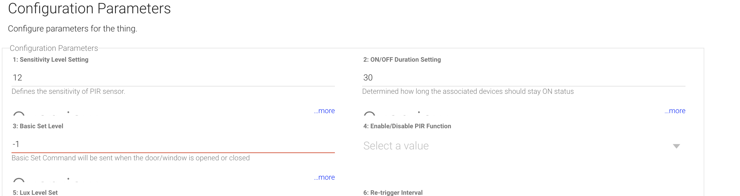

I see. then the device for some reason looses the Enabled PIR. Because I never sent disable.

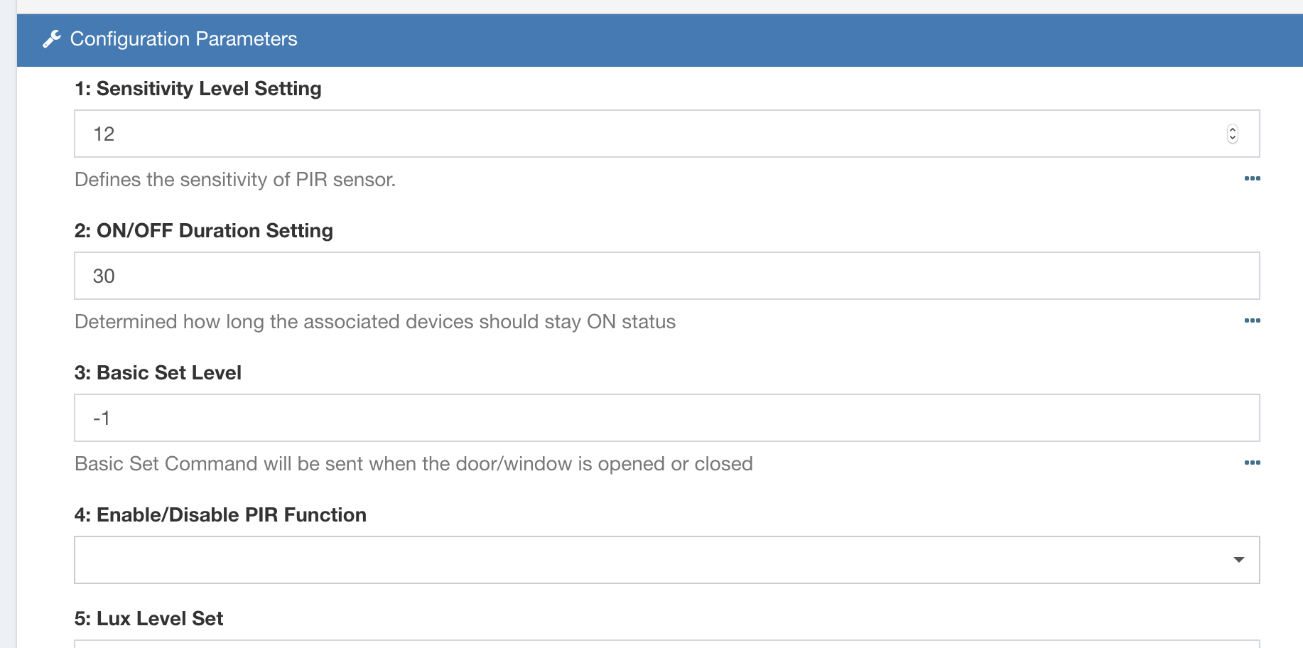

One more question: somewhere in logs config_4_1 is -1 is this equal to 255?
Manual states 255 = Enable and 0 = Disable. But after a while this is not anymore on enable state?
I will seek for the whole log history for this again. If I find some bit and piece of it changing/been set.
Maybe - or maybe you did send disable, but didn’t realise… PaperUI will send all configuration - if it somehow gets the wrong value, then maybe it get changed… I’m speculating, but this is an issue we see occasionally.
Sorry - what do you mean? What is not in enable (ie where does it show, and what does it show).
My Greek-english… GRRRRRR
For some reason the value in property 4 is empty or becomes for some reason (can it be on nightly heal?) or so. And based on your explanation about PaperUI I suspect when I change something else, IF i do not correct this Empty field.. this happens.

Anstering the Wher I am looking:
Same device Habpanel/paperui (taken now). I didn’t save/change anything (about param 4)
the point I found “awkward”/“strange” Is this:
NODE 44: Configuration update ignored config_4_1 to -1 (BigDecimal)
But I might be wrong there.
Probably this is blank as the value is -1, and -1 is not one of the values in the database. Probably this is related to this issue -:
It’s a difficult issue since the definition by many device manufacturers is inconsistent with the standards. I’m not sure why this is set to -1. -1 itself is not an issue since -1 is the same as FF as far as the binding is concerned, but not as far as the UI is concerned.
This just means that it didn’t do anything as the value being set was the same as the current value, so it was ignored. We do this to reduce traffic - there’s no sense in sending configuration parameters to set them to the same value they are already set to…
is there a cure for this issue? Update of DB can help cure this?
I believe this is also related to the old devices, as I have a device without temperature sensor (OLD) and behaves the same on this parameter.
Since I don’t know why it is set to -1, I’m not sure how to resolve it. It’s (another) very messy part of ZWave definitions.
I’m not sure why it’s related to old devices :confused: ? Can you expand on this statement? It should not be related to any specific type of device.
related = affects (maybe wrong again)

@Chris this parameter 4 is becoming blank after restarting openhab.
I have a spare device. I will play a bit around with it. and post findings.
Basically these two become blank/empty after restart:
  1. Param 4
  2. Lifeline
