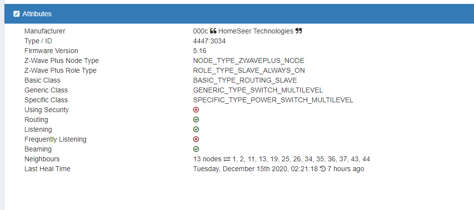

@chris I have a question for you. All of my HomeSeer WD-100+ Dimmer switches are showing grey/delete in Habmin (they are 100% functional though and show correctly in PaperUI):
I just updated Openhab to version 2.5.11, this issue was apparent prior to upgrading when i was on 2.5.10-SNAPSHOT (#242).
Out of curosity i attempted to delete a Node and reaadd it (bad decision). Now everytime i try to add the node (excluded/included it) the logs are showing this:
2020-12-14 23:32:10.993 [WARN ] [wave.discovery.ZWaveDiscoveryService] - NODE 46: Device discovery could not resolve to a thingType! 000C:4447:3034::5.16

On a OH restart and monitoring the logs here’s what all my HS WD-100+ switches show:
2020-12-15 23:26:05.846 [WARN ] [wave.discovery.ZWaveDiscoveryService] - NODE 26: Device discovery could not resolve to a thingType! 000C:4447:3034::5.16
2020-12-15 23:26:05.853 [WARN ] [wave.discovery.ZWaveDiscoveryService] - NODE 36: Device discovery could not resolve to a thingType! 000C:4447:3034::5.17
2020-12-15 23:26:05.853 [WARN ] [wave.discovery.ZWaveDiscoveryService] - NODE 35: Device discovery could not resolve to a thingType! 000C:4447:3034::5.17
2020-12-15 23:26:05.861 [WARN ] [wave.discovery.ZWaveDiscoveryService] - NODE 45: Device discovery could not resolve to a thingType! 000C:4447:3034::5.16
2020-12-15 23:26:05.862 [WARN ] [wave.discovery.ZWaveDiscoveryService] - NODE 19: Device discovery could not resolve to a thingType! 000C:4447:3034::5.16
2020-12-15 23:26:05.862 [WARN ] [wave.discovery.ZWaveDiscoveryService] - NODE 2: Device discovery could not resolve to a thingType! 000C:4447:3034::5.16
2020-12-15 23:26:05.849 [WARN ] [wave.discovery.ZWaveDiscoveryService] - NODE 25: Device discovery could not resolve to a thingType! 000C:4447:3034::5.16
2020-12-15 23:26:05.880 [WARN ] [wave.discovery.ZWaveDiscoveryService] - NODE 20: Device discovery could not resolve to a thingType! 000C:4447:3034::5.16
2020-12-15 23:26:05.886 [WARN ] [wave.discovery.ZWaveDiscoveryService] - NODE 41: Device discovery could not resolve to a thingType! 000C:4447:3034::50.3
2020-12-15 23:26:05.889 [WARN ] [wave.discovery.ZWaveDiscoveryService] - NODE 3: Device discovery could not resolve to a thingType! 000C:4447:3034::5.16
2020-12-15 23:26:05.889 [WARN ] [wave.discovery.ZWaveDiscoveryService] - NODE 37: Device discovery could not resolve to a thingType! 000C:4447:3034::5.17
I see you updated the database for this device and a new snapshot was created. I downloaded the new snapshot for zwave and it’s all working good now. Thank you very much !
