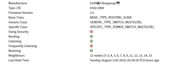

Ill try and obtain more logs, now the node is showing not communicating with the controller laugh so I’ll get that sorted first.

Seems like it did, but its still showing offline

But it’s not communicated for a long time.
dastrix80
(Kris K)
August 11, 2019, 10:24pm
#12
I think we’ll swap it out. This network will be big, over 130 nodes.
