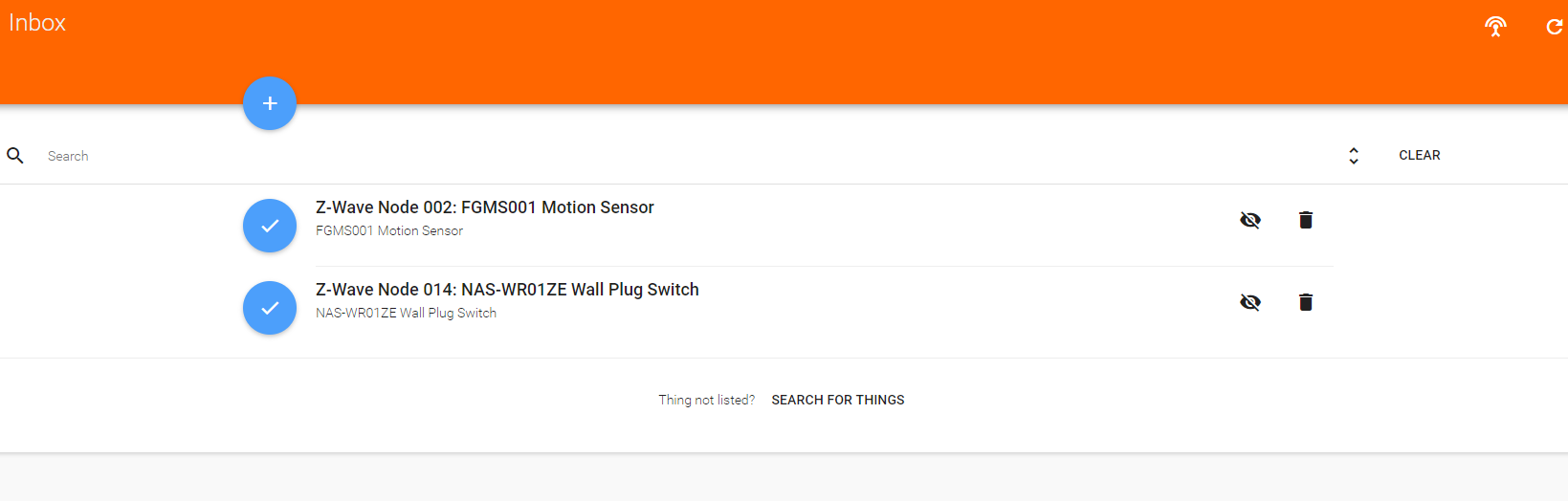

I have a couple ghost devices that I can’t seem to get rid of:
The motion sensor was one of my first devices sitting unused for almost a year. I now wanted to use it for something but for some reason there we no events and nothing in the zwave debug log. I removed and re-added it a couple times to no avail but suddenly it showed up with a different device id. Adding it with the new id worked like a charm but it keeps turning up as the old device id also, which doesn’t work.
The same goes for the plug which out of the packaging showed up just fine but no events. Re-added a couple times, suddenly showed up with a new id and works fine, but also keeps turning up as the old id.
If I add them it looks like this in the debug log, but no further communication:
root@kvm:~# tail -f /tank/syslog/192.168.40.120/zwave.log | grep node2

@chris what is your latest recommendation? I cannot tag this thread as zwave due to 500 error.
Use HABmin advanced settings, set the node to failed, then remove it from the controller, or if that does not work search the forum for how to use the Zensys tool.
Neither failing the nodes nor removing them from the controller has any effect. One stays green and the other is not communicating.
Using a Windows tool is not really an option, but I saw in another thread that Chris was looking at getting the binding to mirror the commands the Zensys tools send, so I guess I’ll just wait until that hopefully starts working.
Thanks,
Torkil
The commands the binding sends to remove the node should be the same as used in the Zensys tool - I think we confirmed that a long time ago. The only difference is that the Zensys tool sends a NOP (ie a ping) and the controller will mark the device as failed if the device doesn’t respond. The binding sends a ping (NOP) to all non-battery devices on startup, so this should also have put the device into the failed list, replicating what the Zensys tool does.
Ok, I’ll restart openhab (to mimic the NOP) and try again. Thanks.
Mvh.
Torkil
That made no difference, node2 still looks all fine in HABmin and node14 is not communicating with the controller. Neither responds in any way to heal, fail or remove from controller judging by the zwave debug log. Any suggestions on how to debug further?

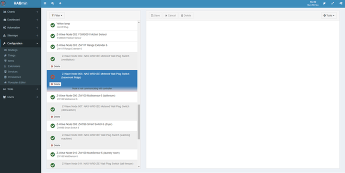

Also half my devices are now greyed out in HABmin with a delete button showing. They seem fine in Paper UI and events are flowing. What’s that about?

That device you highlighted says it is not communicating with the controller.
This usually means the device is not connected to the network. Sometimes unplugging it and plugging it back in helps. I have a couple of those plugs periodically going offline like that.
That device sorted itself but I still have a bunch of the grey’d out ones with the delete button. They work fine though. A quirk with HABmin?
