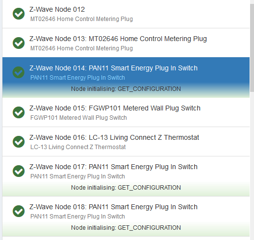

Thanks a lot chris. i now again cleared the xml files to generate from scratch…what i now found out is that for PAN11 switches for whatever reason there is no xml generated. Any idea why. These seem also to be the ones that make some troubles…also i see a “node initialization” message. not sure if this is a problem i should fix…
Maybe something missing in the DB?
Normally this is caused by the device doing something non-standard. We need to find out what that is, and then there will normally be a configuration in the database we can use to work around the problem.
First though is to get a log of what is happening. I would guess that probably there is an error in the database with possibly a config parameter that is not present in your device (based on it being in the GET_CONFIGURATION state).

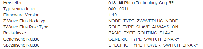

my pan11 work
please note that there are versions from hauppauge that report with same type/IDs but e.g. do not send meter reports… just in case someone starts fiddeling the DB
One question regarding AssociationGroups…when i change the group to controller it is shown in Habmin even if i come back later. After a reboot on many nodes its again a “blank” field or an [x] but no “string” showing the group. Is in such a case still the association group stored already in the node itself? or something went wrong and after an openhab reboot it still should be shown in habmin?
Ok, so we might need to create a new version of the device as yours is an older version than @shorty707. Let’s see.

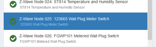

Its the node25…HouseNr_Switch. Can you please check what is the reason that some of my switches do not react to rules anymore…
As written above, its Node25 (HouseNrSwitch) that does not switch ON if a rule requests so. Its happening to several other nodes as well since the major update few weeks ago. Thanks for checking, hope you find something that helps to fix this.
