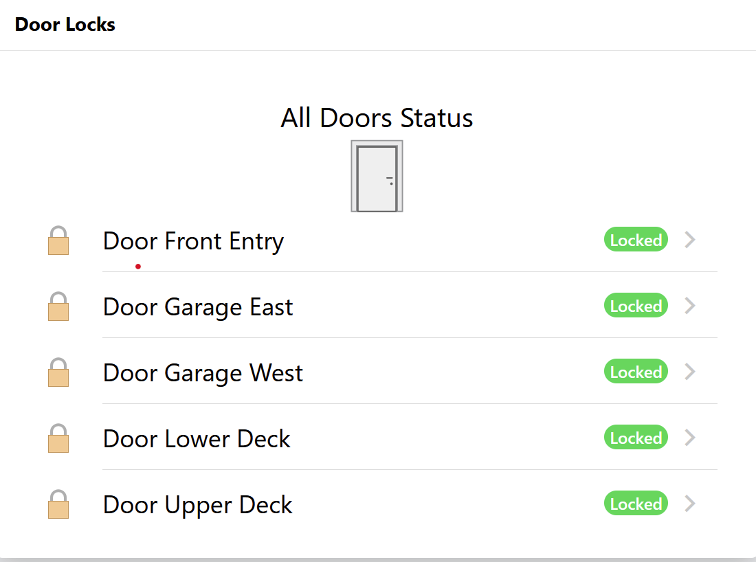

I put all of the door-lock-mode items in a group, and then used that in a custom widget to generate a list of locks with label list items that can lock or unlock the doors.
The door icon can be clicked on to lock all of the doors. The door and the lock icons change based on whether a door is locked or unlocked.
Thanks to JustinG for his widget tutorial and rikoshak for his repeater examples.
 uid: schlage_lock_list
tags:
  - Door Locks
  - Group
  - Repeater
props:
  parameters:
    - default: Door Locks
      description: Title of list
      label: Label
      required: false
      type: TEXT
    - context: item
      description: Group that holds the Lock Mode Number Items
      label: Lock Mode Group Item
      required: false
      type: TEXT
timestamp: Jan 17, 2026, 9:48:15 PM
component: f7-card
  title: =props.label
  style:
    box-shadow: var(--f7-card-expandable-box-shadow)
    margin: 5px
    font-size: 30px
  default:
    - component: f7-card-content
        default:
          - component: f7-block
              style:
                font-size: 20px
                text-align: center
              resizable: true
              default:
                - component: Label
                    text: All Doors Status
                - component: oh-icon
                    icon: '=(@@props.modeItem == "255") ? "oh:door-closed" : "oh:door-open"'
                    width: 60px
                    action: command
                    actionCommand: "255"
                    actionItem: =props.modeItem
          - component: f7-row
              default:
                - component: f7-col
                    default:
                      - component: oh-list
                          style:
                            font-size: 18px
                          default:
                            - component: oh-repeater
                                for: item
                                sourceType: itemsInGroup
                                groupItem: =props.modeItem
                                fragment: true
                                default:
                                  - component: oh-list-item
                                      action: toggle
                                      actionCommandAlt: "0"
                                      actionItem: =loop.item.name
                                      badge: '=(@@loop.item.name == 255) ? "Locked" : "Unlocked"'
                                      badgeColor: '=(@@loop.item.name == 255) ? "green" : "orange"'
                                      icon: '=(@@loop.item.name == 255) ? "oh:lock-closed" : "oh:lock-open"'
                                      style:
                                        padding-right: calc(var(--f7-list-item-padding-horizontal) +
                                          var(--f7-safe-area-right))
                                      title: =loop.item.label
