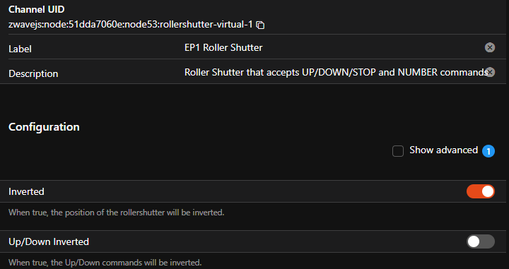

I have many Shelly Wave Shutters for my blinds.
In OH I have to invert the channels, to correctly reflect the shutters position (0=open 100=closed)
It happend several times already, that my OH channel inversions were reset.
I’m not sure when this is happening, but it seems it could happen, if I restart Zwave JS UI or its Docker container. But I was not able to reproduce

Today morning I restartet Z-wave JS (and its container) several times for some reasons. At lunch I noticed that all my shutters have wrong position. Of course my channels “inverted” value was reset.
Now I tried to restart Zwave JS again, but channels are still correct.
Anyone else noticed this behaviour?
Any Workaround? As far as I know I cannot invert positioning on Zwave JS or device side.

Anyone knows if it is worth to file an issue on github? Or is this not solvable within the binding?
If my environment gets reset, I have to reconfige about 40 Channels from 20 Wave Shutters, which is frustrating. Another way will be to invert all of my rules, for example instead of targeting position 80 I use 20. But thats basically not what I want.
