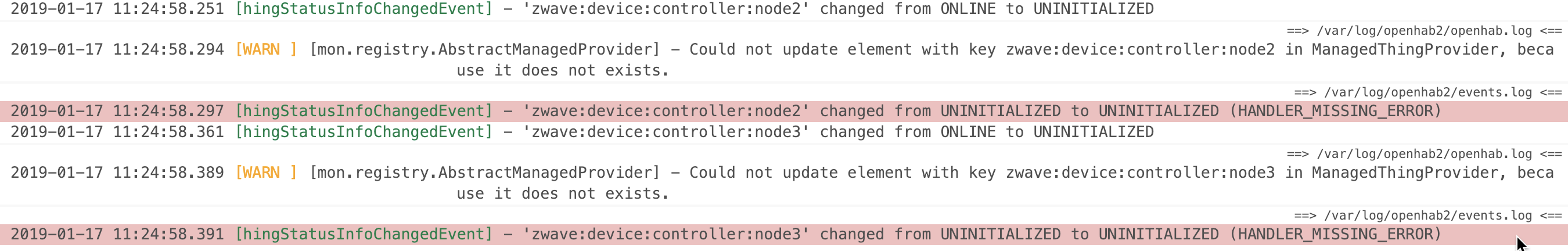

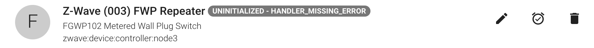

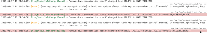

I have a similar issue with manual thing configuration. My controller is working fine and I can add things via PaperUI and use them as normal. But with the manual configuration for the things I get an ‘HANDLER_MISSING_ERROR’. I’m using version 2.4.0 of the z-wave binding.
My thing configuration:
Bridge zwave:serial_zstick:controller "Z-Wave Controller" @ "Z-Wave" [ port="/dev/ttyACM0", controller_softreset="false", controller_master="true", heal_enable="true", security_networkkey="***"]
Thing zwave:device:controller:node2 "Z-Wave (002) FWP Speaker" (zwave:serial_zstick:controller) @ "home" [ node_id=2 ]
Thing zwave:device:controller:node3 "Z-Wave (003) FWP Repeater" (zwave:serial_zstick:controller) @ "Z-Wave" [ node_id=3 ]
The error:
This appears in the log when I refresh the *.things file:
Am I doing something wrong with this manual configuration?
I’m not sure what the error is, but for starters you have not defined the things correctly. You can’t use the thing type zwave:device:controller:node2 - you need to define the correct type for your device not the generic one which is used if the system is defining the configuration.
Sorry I don’t quite understand the problem with the generic device type. Isn’t it the right way like Mickroz did it above?
If I change something in zwave:device:controller:node2 the thing isn’t recognized anymore in PaperUI and auto discovery finds the thing again so you could add it via PaperUI.
