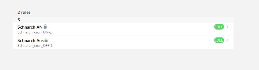

after unplug and plug it back i get the information in PaperUI - see pict 1 above - that there is a communication error and i can not use the node by GUI - pic 2 with slider above
But I have created a rule (old rules) that power the device on or (secound rule OFF) triggered by time (cron)
the rule:
rule “Schnarch AN”
Time cron “0 30 23 * * ? *”
sendCommand(Schnarch_Fib_FGP101, ON)
sendBroadcastNotification(“Schnarch_Fib_FGP101, ON - cron”)
logInfo(“Schnarch.rules”, “Schnarch_Fib_FGP101 AN”)

The rules works!
When I run these rules by PapaerUI using the “blue play button”
it also work.
