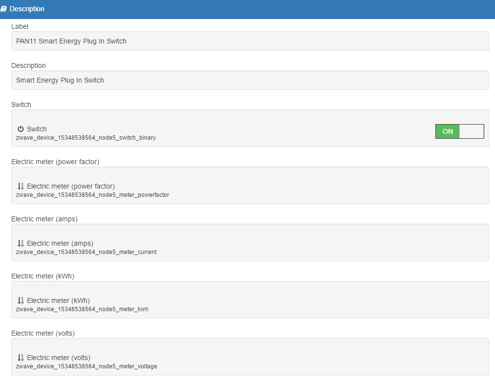

Hi there,
I moved from an UZB Zwave Stick to a AeoTec Zstick and therefore basically started over.
Removed all Things … included all new on the new stick
some things are strange now :wink:
my Philio PAN11 power plugs don’t show the current voltage and watts anymore. However I can turn them on / off
they also show constantly up in the log (not debug level):

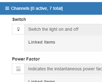

  1. When I add new Things it happens all the time that either not all or no chnannel gets created automatically. When I remove the Thing and readd it … it sometimes works.
thanks :slight_smile:

well heres a log where I switch on and off
Node 5 --> doenst show watts / volts
Node 2–> works fully
seems like Node 5 is not sending any information about METER … however the channels are there:

There are no meter reports being received, so as above, I would check the device configuration.
sorry forgot to mention
I did … all config looks good and is identical for node 2 (working) and node 5 (not working)
greetings
Ok, but I still don’t think there’s anything I can do to help.
If the binding isn’t receiving any data, then you need to look at the device configuration. The only way the binding might be able to help is if you want to enable polling to get the data, but IMHO that’s not a good idea and without knowing the device, I sincerely doubt it’s needed.
could this also be an issue with how the device is “described” in the database?
You should read through the device manual and see what needs to be set. If the manual says to set something in the device, and it’s not in the database, or is incorrect in the database, then yes, we need to fix that, but otherwise it won’t be an issue with the database.
what I observed is that when I set the association for “Openhab Controller” in Habmin
then automatically all channels / items are depopulated and I have 0 active channels
and also asscociation group 1 is blank again and the Controller is not in there
mhhh
and all “PAN11” do show get config in habmin
