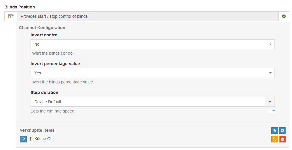

There are some discussions in different forums if “up” is “100” or “0”. :grinning:
In my case “up” is “0”.
Luckily with the FGR222 you can easily invert the channels percentage or control:
