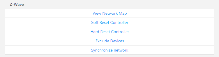

So, I decided that I would try to exclude and re-include this device. I tried using the “Remove Device From Controller” which I suspect is Exclusion. I did that while holding the button on the device and I believe it was successful as the device went offline in OH. Now, however, I cannot get the device to get included in the zwave network. Every time it is unsuccessful. I’m not sure if I am doing this correctly. The instructions manual says you are supposed to hit “Inside Schlage button->your programming code->0” and it puts the device into inclusion mode. It appears to work, but it always blinks the red check indicating it failed. Does anyone have advice on how to deal with this device? Am I still running into some kind of issue with the security feature on this?
