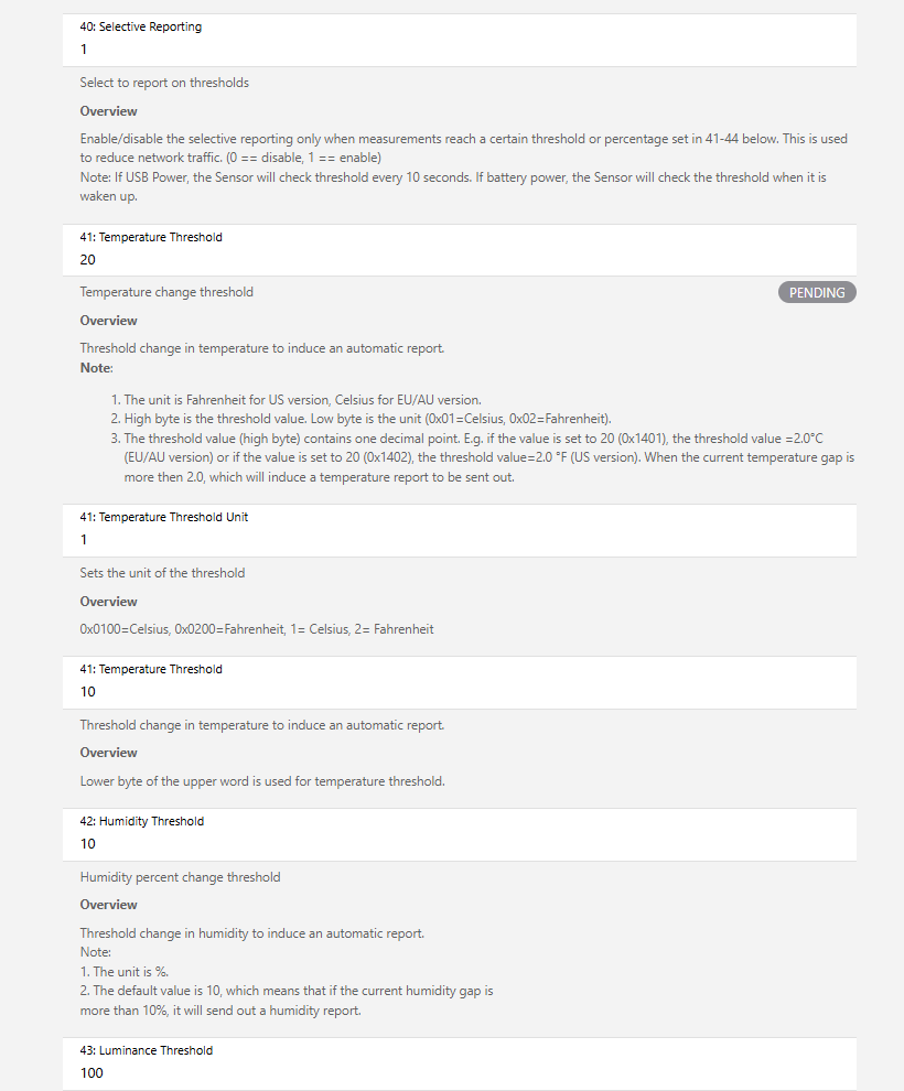

It seems the Zstick is full and this sensor (zw111 aeotec motion sensor) wont shut up, despite turning on selective report, changing the thresholds and turning command poll off. I have two of these and they are both USB powered.

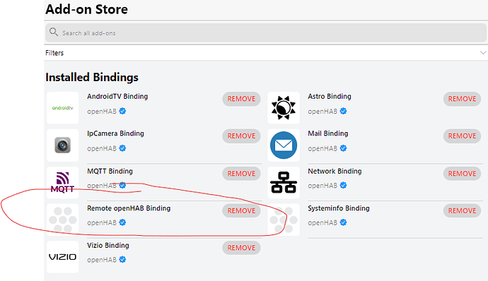

For unsolicited advice why aren’t you using the remote OH binding?
I am using the Openhab binding, 5.1.0.

I have nothing against the MQTT Event Bus (and used it years ago) and possibly I don’t understand your set-up. My unsolicited advice was the remote OH binding available in the OH5.1 store.
Also Zw111 is nano dimmer and doesn’t have the parameters in your picture
Anyway, another clue could be to set the ZW binding in Debug to validate the ZW binding is sending state updates consistent (or inconsistent) with the thresholds you have set. You can use thezw debug viewer to summarize the log.
Ah good catch! I didnt even realise I had the remote openhab binding as I’ve been using MQTT for a while, seems its legacy. I’ve removed it. Sorry the sensor is the Aeotec ZW100 Multi Sensor
It is not legacy. There are situations where MQTT is a better choice or where the remote openHAB add-on isn’t available. I still maintain it and will do so for the foreseeable future.
But that doesn’t mean the remote openHAB add-on isn’t a better choice in this instance.
I mean, legacy in my environment :slight_smile:
