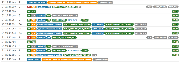

I’m having an issue with the state update applied to my ZWave nodes. The behavior is I apply a command to a ZWave device. The command is received and processed. However, the state update on the device doesn’t match the command.
Example:
Apply Dimmer switch command: from 100% to 0% (simplistic example)
Device behavior: Light turns off completely physically (so 0% on light itself). So success here!!
State within HabPanel or Paper UI: 49%. So failure in setting correct state update.
Note: If I send command from 49% to 0%, then the state update will then be set to 0% correctly. Just happens in 2 commands instead of 1.
I changed the log debug level for ZWave logging and ran it through cdjackson viewer. Captured the activity related to Node 9:

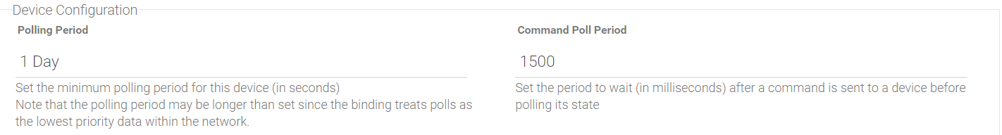

You need to increase the repoll period for this thing - the binding requests the state of the device after it has sent a command - if the device changes slowly, then you need to increase this to give it time to complete.
Thank you sir. And if I wanted to discover that setting by myself, how would I do it without pinging a senior SME like yourself? Is it configured in a software artifact somewhere?
If it’s a non-trivial answer. Forget about it. Just trying to be self-sufficient.
