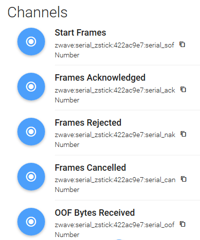

  • Issue of the topic: I accidentally deleted the serial_cse channel for the Zwave sticks.
    Can’t find a way to get that back. It prevents the detections of Zwave nodes to function OK.
    I have tried two Zwave sticks, result is the same.
    These ared the normally configurable Channels:
    |Channel |Description|
    serial_sof |Counts number of frames started|
    serial_ack |Counts number of frames acknowledged by the controller|
    serial_nak |Counts number of frame rejected by the controller|
    serial_can |Counts number of frames cancelled by the controller|
    serial_oof |Counts number of bytes received out of frame flow|
    serial_cse |Counts number of frames received with checksum error|
    The last entry does not show up.

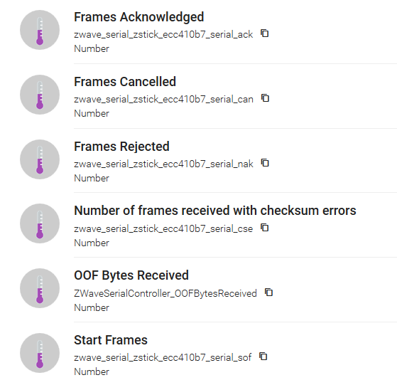

Just link a number itemtype to the channel:

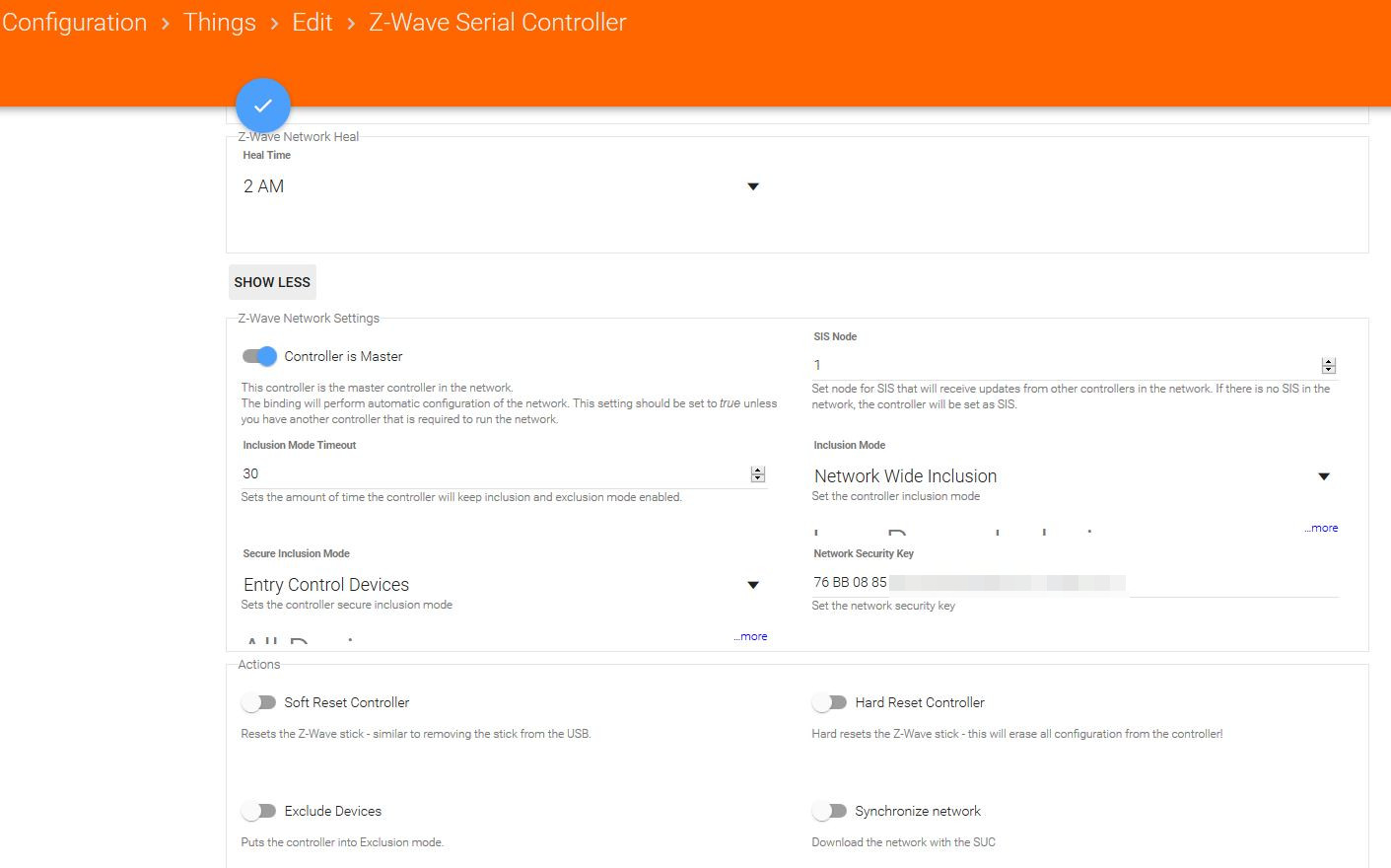

No, the channels of the zwave controller have nothing to do with proper inclusion of zwave devices.
Or are you referring to the “Network Security Key”? If you did not backup that one you are out of luck and need to reinclude your secure devices.

I added the channel, please see below. But it doesn’t show up under items to be linked under the Zwave stick.
