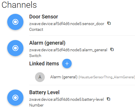

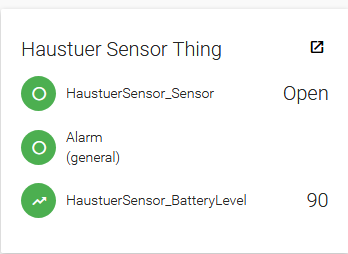

I have a “ZWave Aeotec Gen5 Door/Window Sensor” which works ok [*] with openHAB 2.5.0.1, just the temper alarm (switch checking if device is (un)mounted) seems not to work.
I thought that would be the alarm_general channel, but in the UI a respective item

At least my sensor does have that switch (maybe it is a newer version) and when pressing it also some stuff is received in OH - see excerpt from the log. “Just” I don’t get it displayed in the UI / item:
