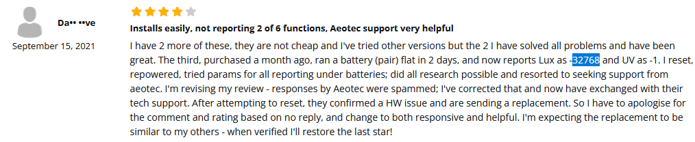

I have the same problem (-32768) with the same device, aeotec multisensor 6. It’s the third in the system and the only one with the problem. It’s usb powered and I tried restarting it, restarting the pi, reinitialize, heal etc. . All the others and the other aeotec trisensors work fine.
I’m on 3.1.0, should I maybe update?
I wouldn’t exclude a HW/firmware defect, contact Aeotec support.
Source: Aeotec Multisensor 6: Z-Wave Plus 6-in-1 Smart Vietnam | Ubuy
Yes, I suspect a hardware defect as well. It’s weird that it worked before.
Thank you for the suggestion. I’ll try to contact support.
