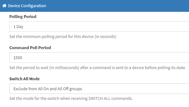

Is it polled regularly, or does it report unsolicited periodically? Then you can detect those periodic updates and ring a bell when one or more is missing.
The expire binding was created for this purpose, but there are other ways. The Item state UNDEF is useful in this context, to indicate “failed”.
