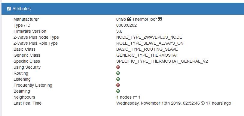

Post a screenshot of the attributes from HABmin. That is what OH sees from the device. Like this,

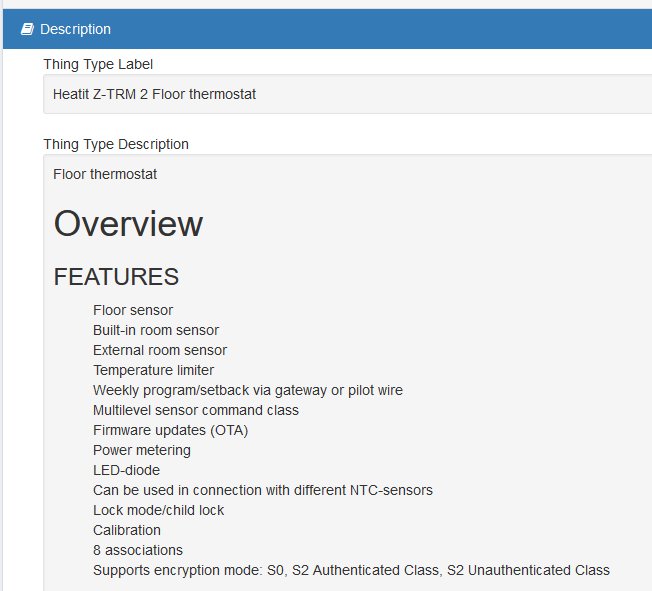

Just to be clear. This is what it gets from the db, which is not correct.
Should have been this one:

Im feeling the discussion is going off topic. What could be the reason that my Thermostat v. 3.6 is getting identified incorrectly, and shows up as the thermostat previous (by far) to my version?

As you can see from my previous post, the problem is that my thermostat gets incorrectly identified in the inclusion process. My thermostat is Z-TRM2fx (fw ver. 3.6), but it gets identified as Z-TRM 2 (fw ver above 2.6).
This is what HABmin attributes looks like, but it still gets identified as Z-TRM 2. It should have been identified as Z-TRM2fx.
