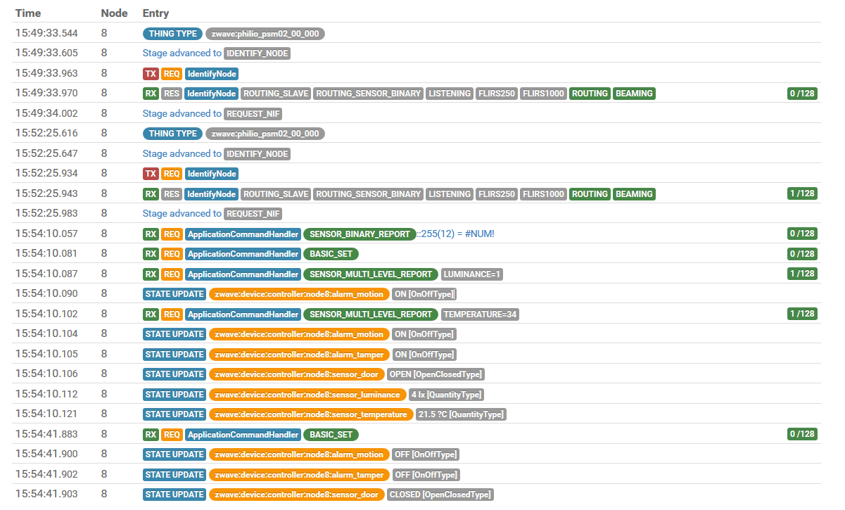

This is what I get from your debug log through the log viewer:
It definitely shows the behaviour your are talking about.

This looks to be caused by the device sending the BASIC_SET command, which contains no information about what type of sensor it is. This command class is (was!) then linked to the BINARY_SENSOR class, and with no type of sensor, it just triggers all types.
I’ve removed this link, but now it will not trigger at all. Ideally the device should be configured to send the BINARY_SENSOR command, but I don’t see any way to control this, so I don’t see how it is possible for the binding to know what the sensor type is.

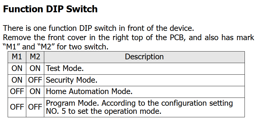

I don’t know if it makes a difference, but are you sure you have the DIP switches set correctly?
Please keep in mind that it worked perfectly under the “old” zwave binding, with exactly the same settings. There must be (i.e. “is”) a way to distinguish between the two sensors.
I understand that you changed something. How do I get this into my system? Remove the thing and add it again? (or can I just edit the json? :slight_smile: )
I am pretty sure that this is correct as it worked under the old binding. I will check later on though.
