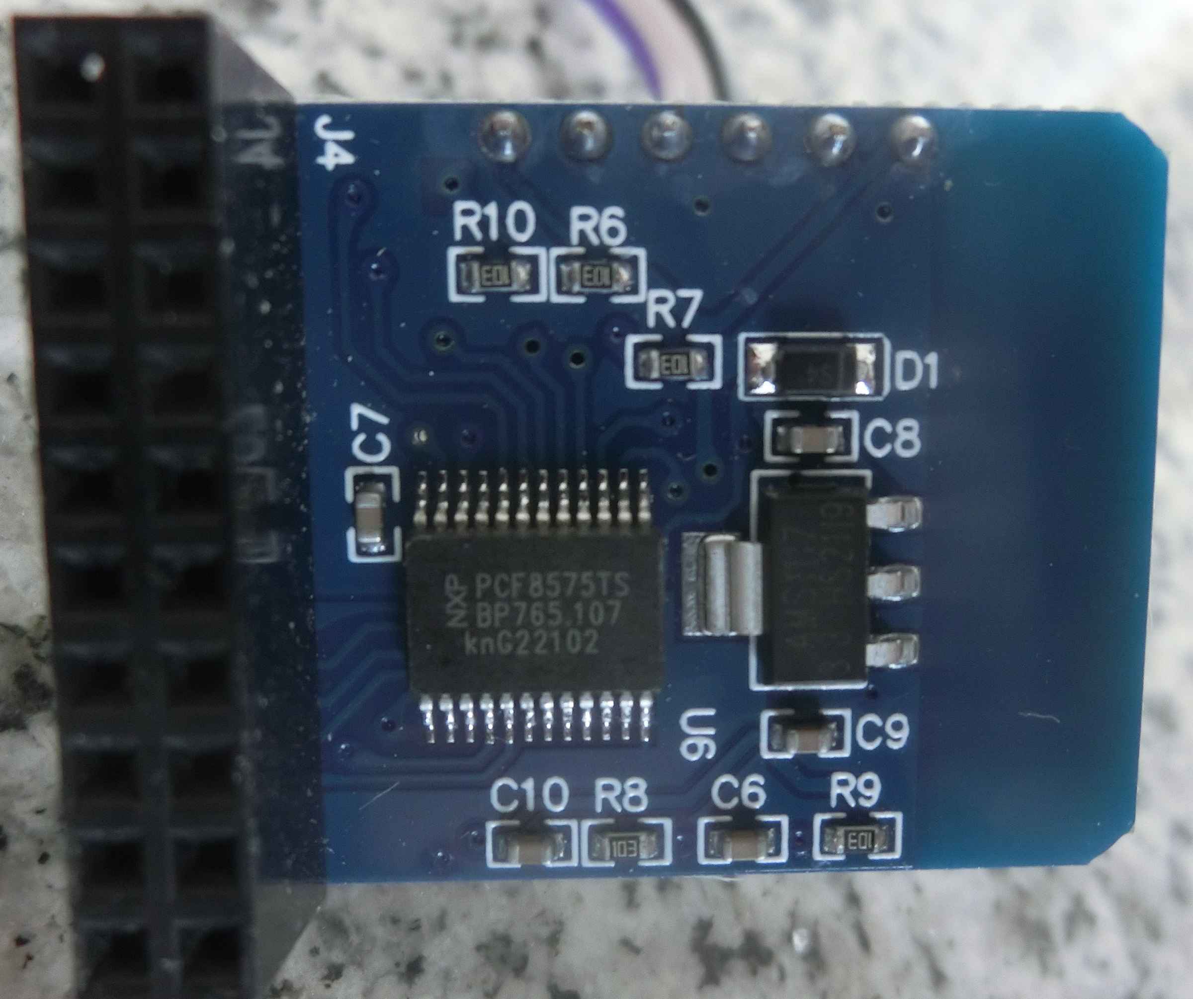

I bought a12Volt 16CH Relay - Card with an ESP8266 WiFi Chip and an I2C-Extender PCF8575 to control 16 Relays thinking it would be easy to flash ESPhome or Tasmota on it.

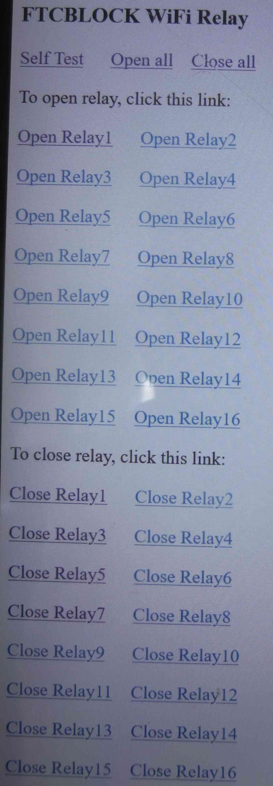

So now I am stuck with this wonderful Card which only offers an Accesspoint were I can switch on and off the relays but can not change anything, not mentioning controlling it by Openhab.

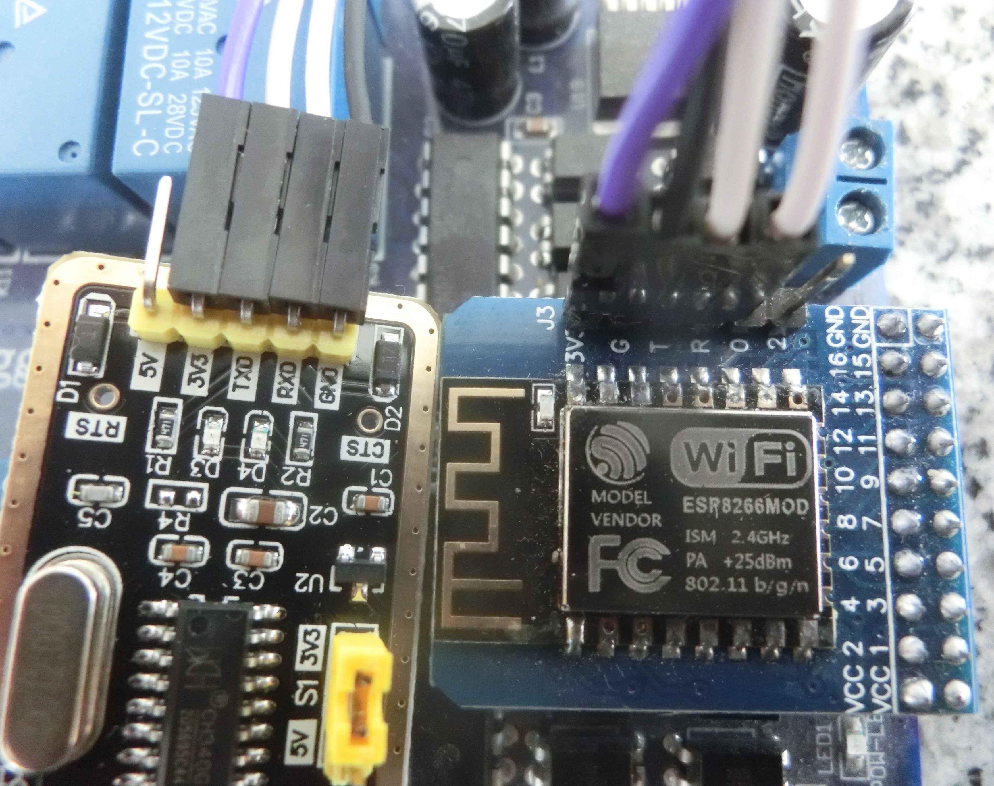

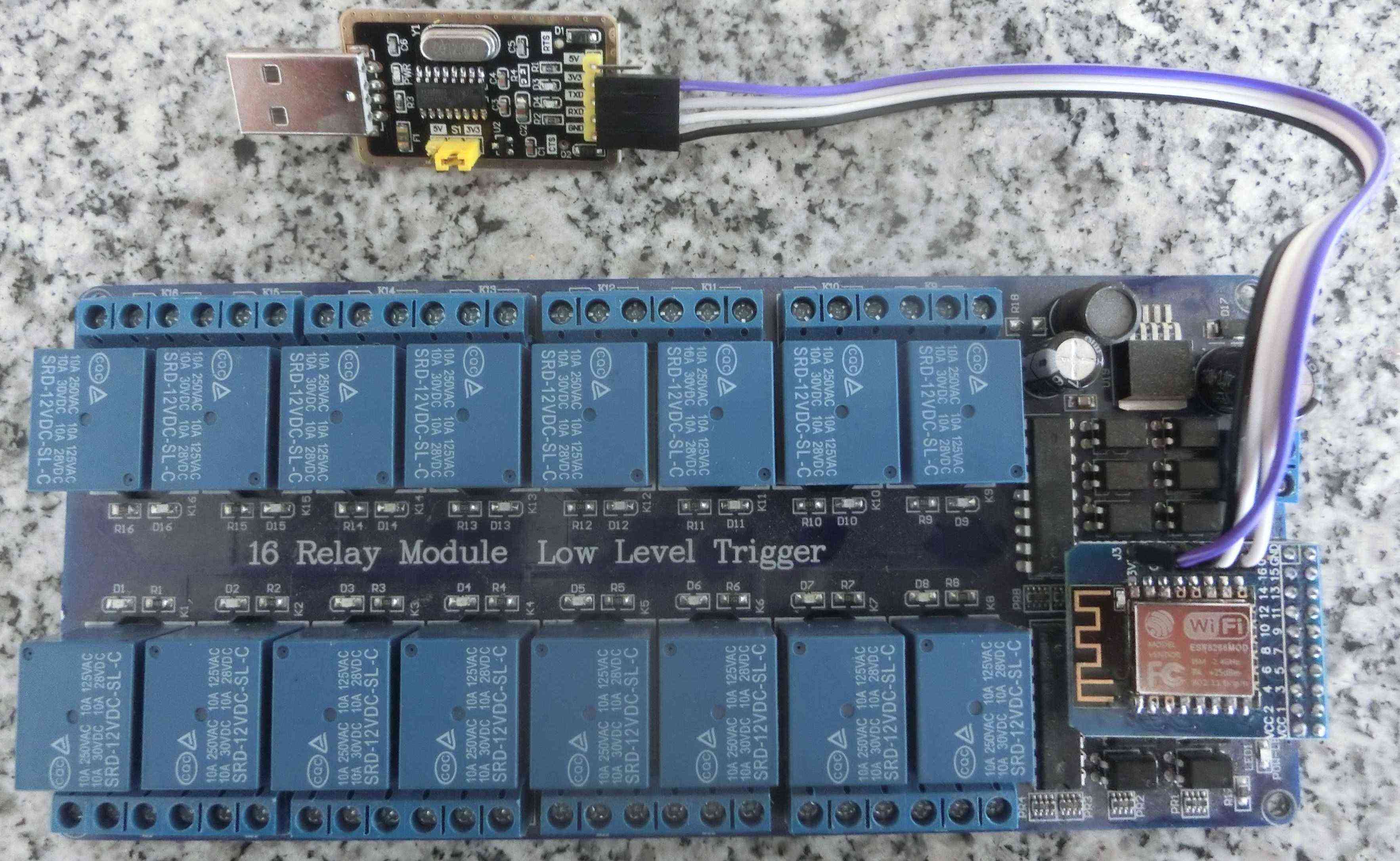

On the Images attached you can see the writings on the parts the available pins and my USB-TTL Converter which I intended to use for flashing a new firmware.
DC5V 12V 16 Channel Wifi Relay Module Onboard ESP8266 WIFI Module Microcontrollers Interface
ESP8266_16CH_Relay
ESP8266_I2C-Extender_PCF8575_on-bottom
ESP8266_Pins+Connection
ESP8266_Rel_Orig.Firm.192.168.004.123_abcd9527

I am sure it works for your device, but this one opens a own WIFI-Access-Pont, a seperate Wifi.
The name and the short default password are everywere on the internet and it can not be changed.

I did not find the Expander with Tasmota, but on the ESPhome website:
Correct, Tasmota does not seem to support the PCF8575.
Assuming you are working on a Windows computer, the basic steps are:
Good luck.
If you encounter any problems during flashing the fastest way to get help is through their forums.
